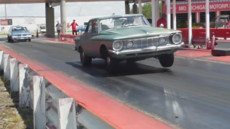

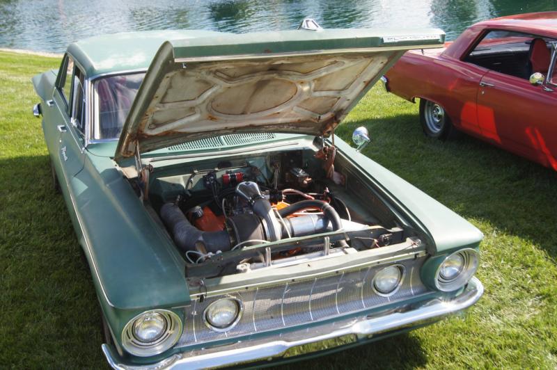

My son runs a 360 powered 62 Plymouth. The car and motor were nearly all stock w/ a 76mm turbo. It went as quick as 1.50 60 ft with nothing but rancho shocks on 2.55 M/T radials, running lower boost at 10.60s. Later in the year after several converter swaps,3 .23, cal Tracks, 275 M/T and slowly working the tune it went 10.08@136 but only 1.60 60 ft. This year we're stepping it up. 10" wheels, composite mono leaf, custom valved Afcos. With a turbo drag radial car it's about boost management, converter, gear ratio, and shocks. 2.76 gear works well with a Torqueflite. We're now going to a 3.55 only because we're using a Dana, may have to go to a taller tire to kill some gear. This car weighs 3750 race ready, this year about 3800.
