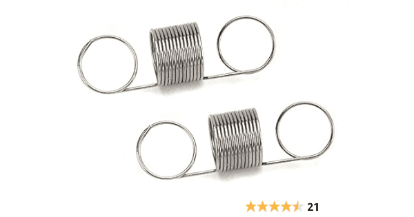

I use the Mopar distributors because they have a vacuum advance. On my one car (stock stroke 440, moderate mech cam, alum heads, headers, bunch of carb) I modify the basic design. I use a 9 degree plate, a light primary spring and heavier secondary spring with the loop, and a limited vacuum advance. The springs I use are old factory stuff that I have an assortment of. I use 18 degrees initial and the light spring allows for 22 degrees at 900rpm. The light spring by itself will allow about 28 degrees total below 2000rpm. The heavier spring will allow 36 degrees total at around 2500rpm. The 9 degree vacuum advance has a small washer "glued" between the housing and notch in the arm. It limits the vacuum advance to about 6 or 7 degrees now. I keep total with the vacuum advance to 48-50 degrees. I built a bunch of curves and just trailed and errored my way thru this. For my car and the way I drive this set up is darn near perfect.

Lots have the timing jumping around and cure it with a lock color on the distributor shaft. It keeps the drive gear seated in the cam gear.
Watch those collars I have seen the set screws come out. Usually masks a worn tower bushing really. MP or Mr Gasket springs are super light and will cause it also at idle. On a points system if it is a bad ground the timing will walk also.
