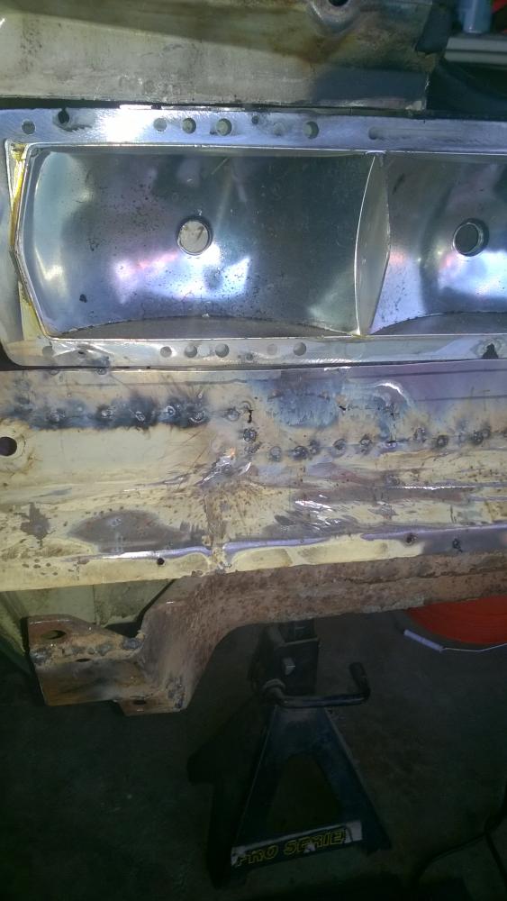

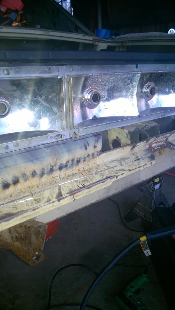

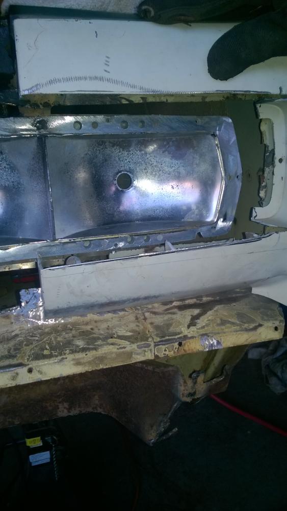

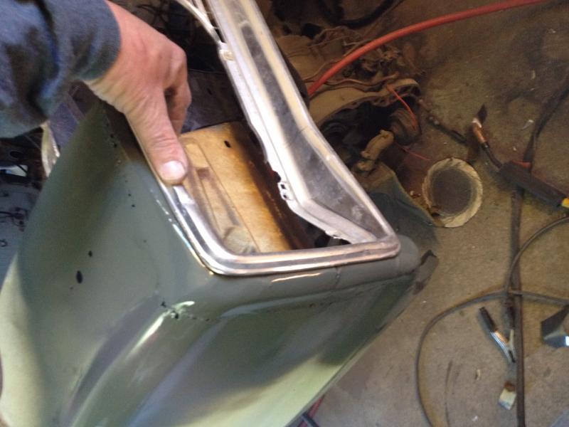

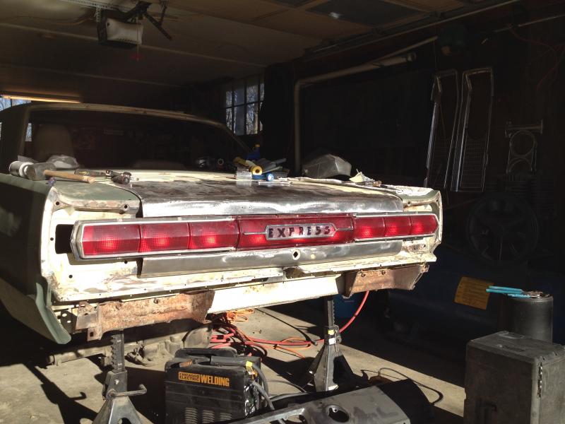

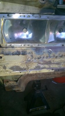

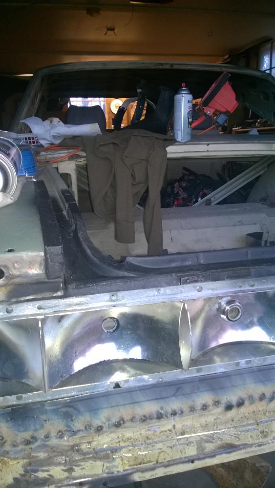

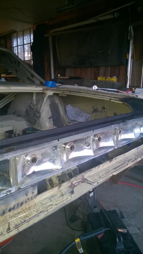

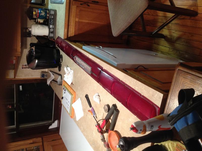

Looks way cool. A perfect restoration is cool, but it's too much work for me. I want some personal touches.I went to the salvage yard today and pulled the tail lights off of a 66 T-Bird. I like them. I cut the bird out of the middle of the center chrome trim piece and the bars also leaving just the oval shape. I will drill some holes to mount the word "EXPRESS" right in there. Coolness. They, like the 66 Charger set up, are about 2 inches short on either end. However, I will cut a hunk of 20 Gauge for each end and shape it to match both the end of the light trim and the inside curve of the quarter extension shape. Paint that black to match the outer edge of the chrome trim and that should be okay. The center panel was smashed but I gathered all of the hunks and I just finished using Krazy glue to put it back together. It will do until I can get a new one. I also pulled the buckets and the insides were pristine not a bulb or red cover broken. Got the wiring harness as well. Here be some pics...and yes, they will be sequential blinkers.
View attachment 286831View attachment 286822
