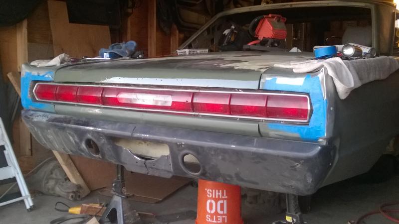

Hit a milestone today, I have the tail lights set up. I wont do the welding of the extensions until I can afford the Super Alloy 1 brazing rods. I did not end up using the bottom lip of the trunk lid to fill in between the lower extension ends. It had the lock hole in it and was pretty bent up. So I fabricated two pieces and then stitched them together in the middle. All of the trim mounting screws are not in and the extensions are just hanging there so it's still a bit uneven and the trunk back edge is unfinished still. After some fine tuning of the shapes and curves and a bit of filler here and there it will all line up dead straight. Here's the pics.
Looks good ghostrider
just like I said in the other tread...LOL

Tail lights came out sweet!
I will, I need to get some more parts off of the Audi A6 and it has small window motors on all four doors. I'll get all four for peanuts. I'm going over there tomorrow and see. It's only three miles away. Thanks! I like them too. Still a few bugs to work out like wiring and some fine tuning to do but they came out ok I think.
Ghostrider, I'm liking the tail lights! It's going to look awesome when finished. The head light mod sounds very do-able and should work with a little trial and error. I look forward to how that'll work out.

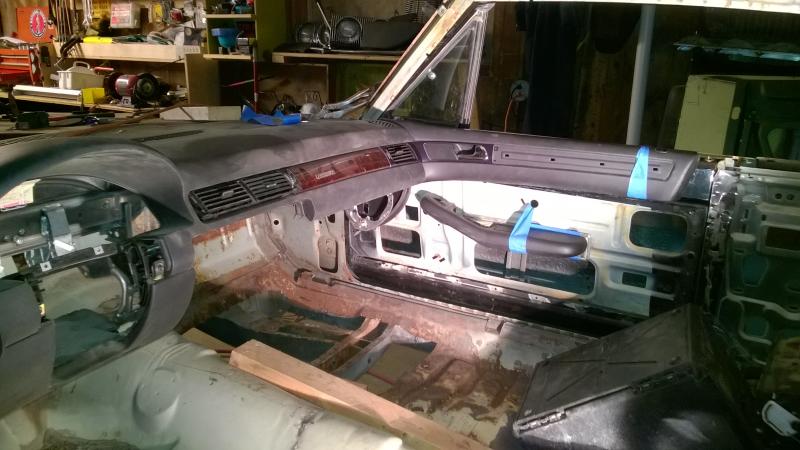

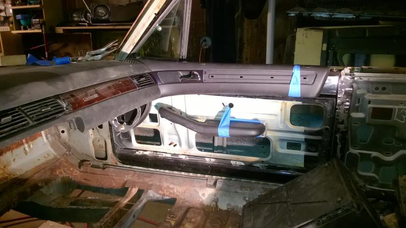

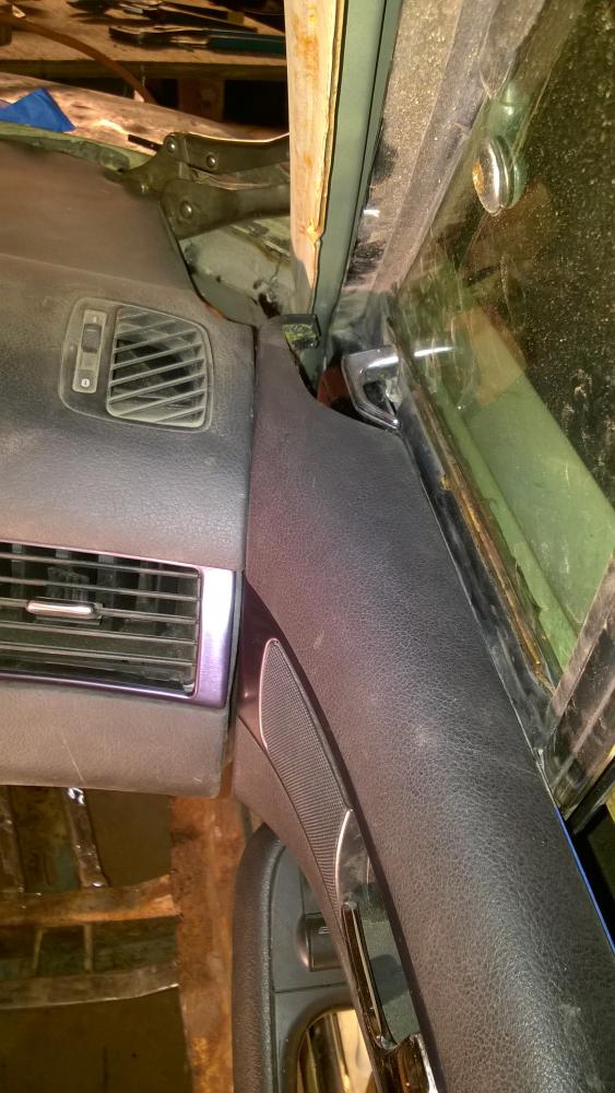

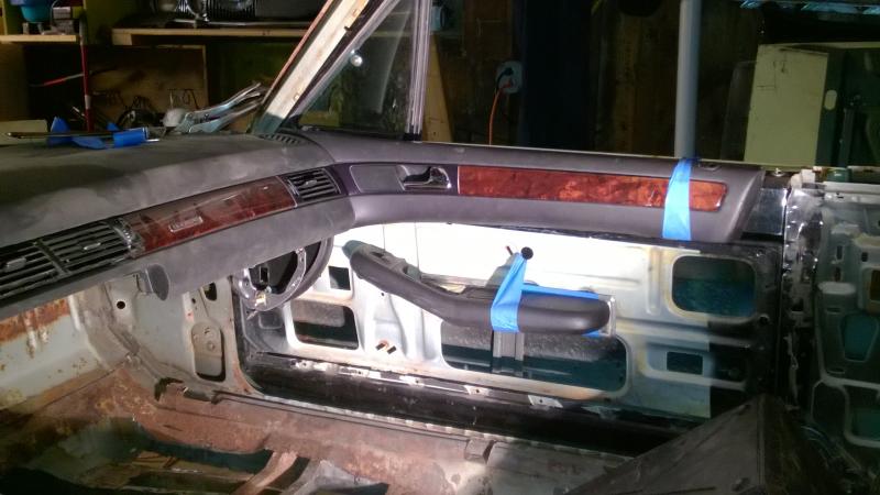

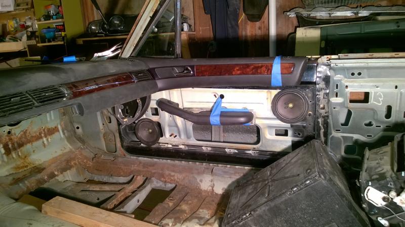

Ran out of welding wire so I started fooling around with the door panels. The Audi doors won't work as is so I'm taking them apart to use what I can so it all blends in with the dash. I worked out the '67 armrest base/ 2002 door pull handle situation by hollowing out the 02 arm and handle body and trimmed the 67 base to fit inside it as well as slicing 3 inches out of the base. I pulled the top section of the door apart and it's going to work out i think. I can fasten it to the door along the bottom edge which will be covered by fabric. So here is a mock up of what I have so far. I might add the CD controls and flip out storage along the bottom of the door, i have to put the glass back in first to work out any interference issues with the crank and frame. I like how the old opening for the post cover makes a perfect space for the wing window handle. I might try to do some fiberglass panel work to blend in the speakers and the rest of the elements on the door. I also need to decide what to do about the way the upper section ends before the end of the 67 door.
