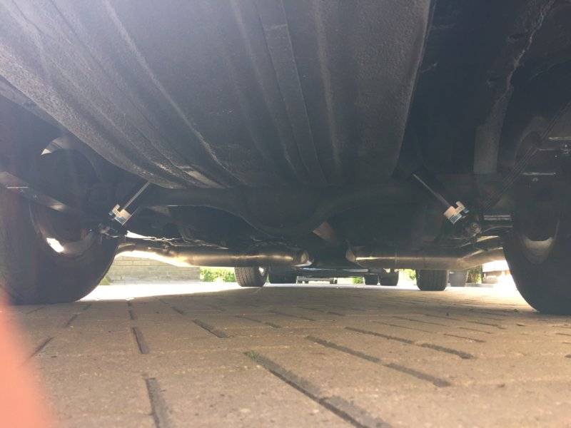

Note in the above pictures the U-bolts are not sitting straight, i did straighten them up before i torqued them up.
Also the front bracket (which i installed first) did not sit straight, better keep the bolts loose until the complete spring is hanging in the rear support as well.
Then it will find it's "home" position, i had to loosen the 4 nuts again to allow it to straighten itself up.
Now just waiting for my package from Summit Racing with my pinion snubber and it's a done deal!
