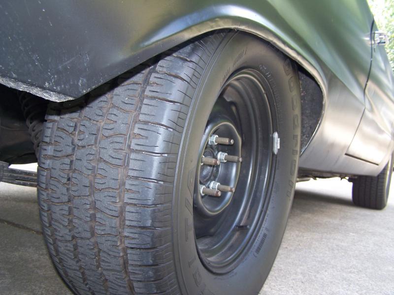

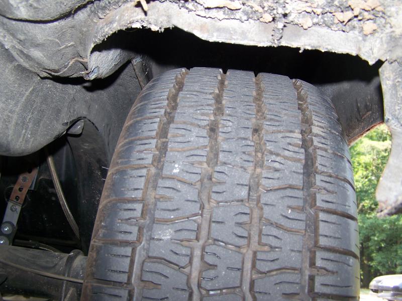

I trimmed my wheel lip just to make sure here are a few pics & mine installed easy put jack stands under the car & let the rearend fall all the way down mine went right in.. I now have Mickey Thompson ET Street Radials current car picture.
I have 275/60/15's on the rear of my '66. Like 67coronetman says, jack that side up allowing suspension to fully extend, shove tire/wheel in the wheel well and onto studs....... No problems. And I haven't even trimmed my fender lips.
7" wide rims will pull the sidewalls in more. When I switched from 15X7 wheels to 15X8 wheels I needed to roll my quarter panel lips to make my 9" X 27" slicks fit. They same slick fit fine with the 15X7 wheels.

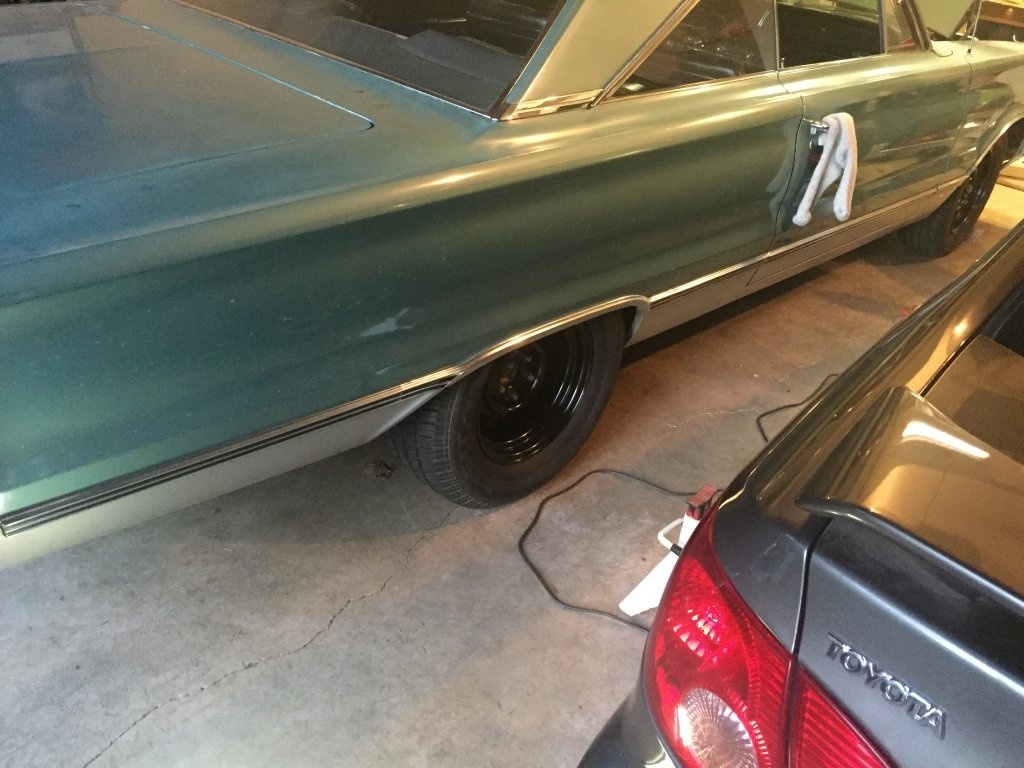

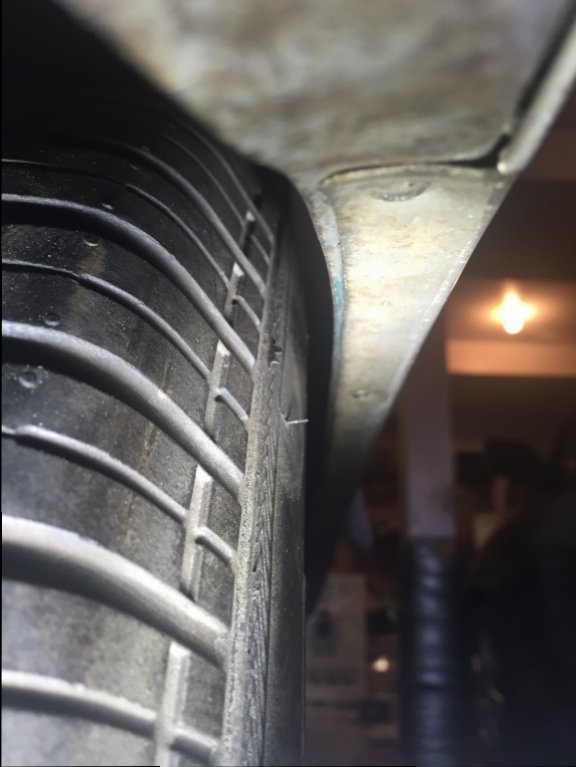

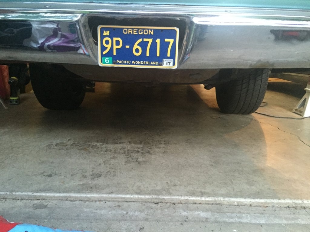

Well, they're in! Going to have to trim or roll the inner fender lip especially front and rear of the lip. Looks wicked though!

Wow, watch out for speed bumps lol. Check your inner fender wells it usually curves inwards. When your rear suspension works the rear sidewalls may rub the inner fender. Could raise the rear ride height a bit.
Well, definitely not going to work, Inner wheel well rubs. Going to have either go with a different offset or massage the the inner wheel well.
