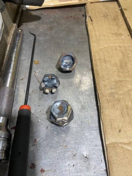

just so happens i removed one today. impact wrench rounded out the square hole. welded a 3/8 grade 8 bolt in the hole which broke off leaving aprox 1/2 inch sticking out of the plug. welded a 1/2 inch nut to the bolt stub and to the top of the plug at bottom of the nut. put 3/4 impact socket on the nut and hit trigger on impact. viola! finaly came out. simple huh?

And there ya go... I'd probably grab a 5/8' or 3/4" nut & MIG through the nut, down into the square recess & keep burning wire till the nut is full to the top... The heat will help even more than having something solid to put a socket on...
Is it’s rusted in place. No amount of spray or candle wax will do anything. Heat it up dull orange with a torch. Burn the paint off, no big deal. Let it cool a few minutes and it will come right out. Won’t damage the plug at all

If you are really worried about running a torch under the hood. Just take the water pump off, remove the plug and then you can touch up the paint... Another solution.. Have you tried removing it after getting it up to temperature? If I remember doesn't a 3/8 extension fit in there... A few blows with a hammer to shock the threads while hot loosens a lot of stuff. Good luck.

Decided to take advice and work smarter not harder. Lets this sucker out of here, gives me the opportunity to get out the rotted heater hose nipples also.
