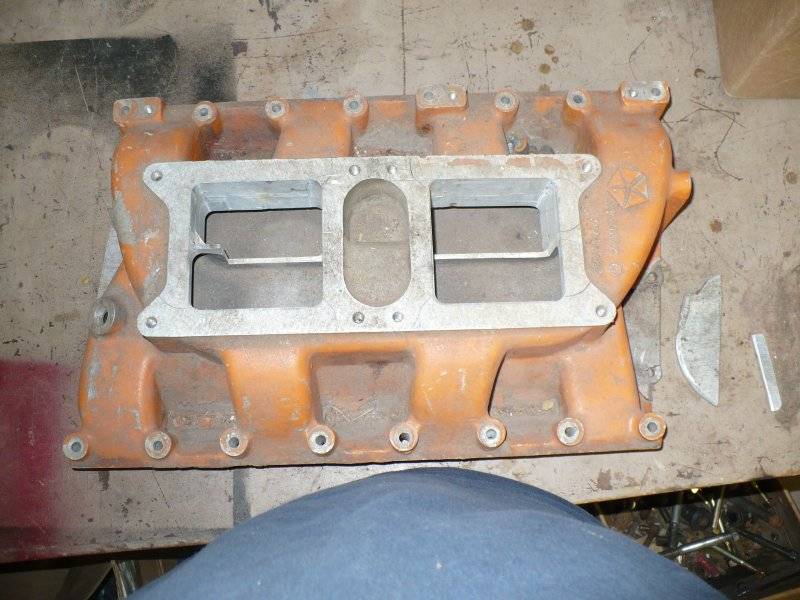

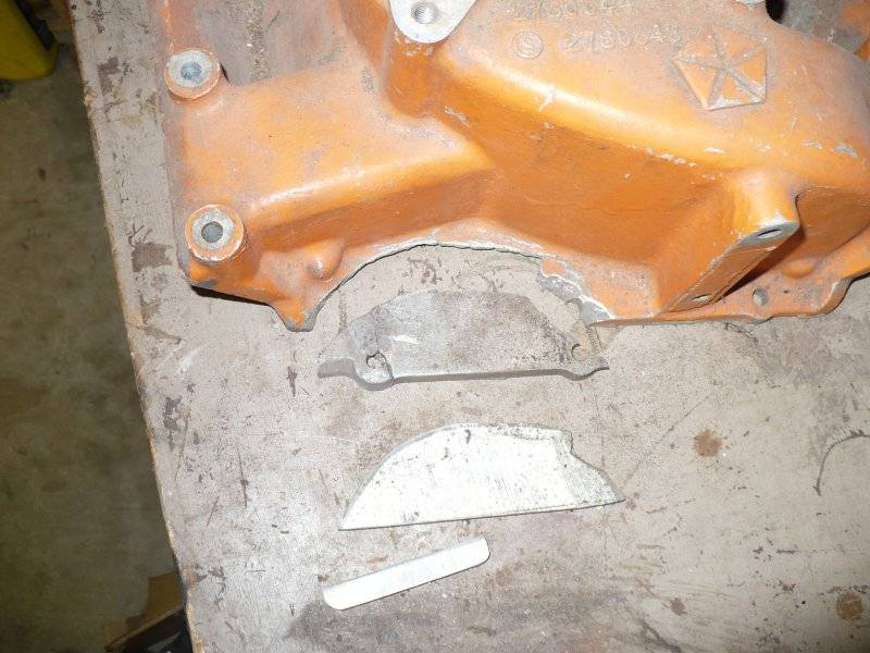

I didn't remove this intake. Some of the chopping is mine, to make a Vanke manifold. could weld from bottom, cut first think later.
I was trying to avoid something like that from happening.
