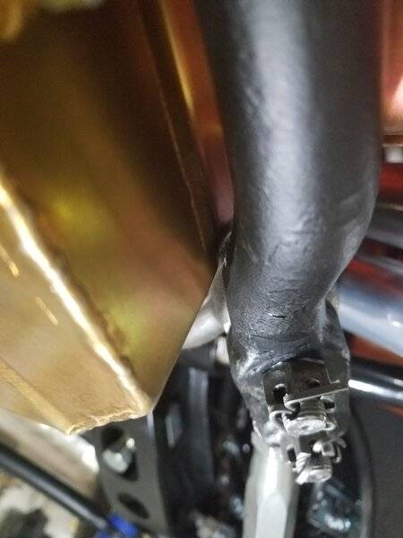

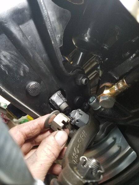

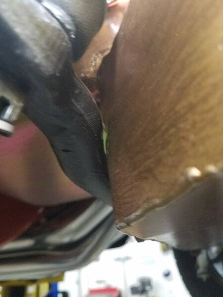

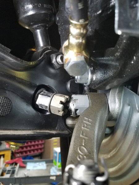

So you guys tell me if this is to "redneck". I can't find any tall 9/16 fine thread tall nuts. I put a thin washer and then a castle nut that I have on the end of the strut rod. With the dent that was already in the pan, I now have a tad of clearance. Probably 2.5 to 3 threads are into the nut. Think I should put a bit of loctite on and run it? Or is it a stupid idea?

I'm a redneck and that seems a little too redneck. I typically don't like to mess with the security on front end parts. Failure can be catastrophic.
Despite how well that pan is built, can't you get in there with a punch or something and place a couple of precise dents to give you a quarter inch or so?

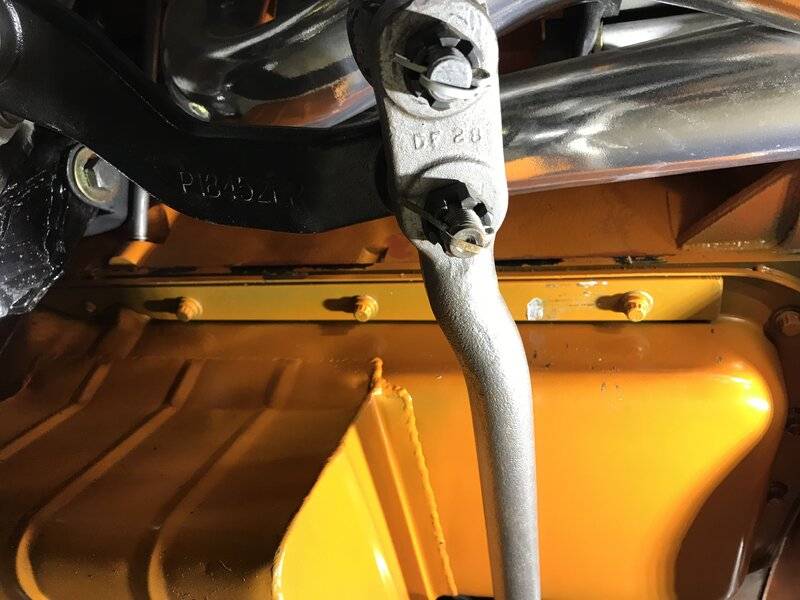

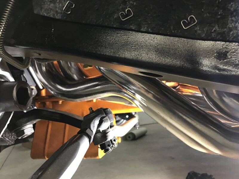

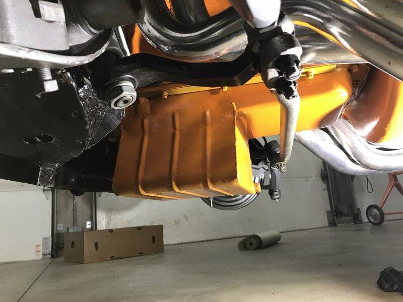

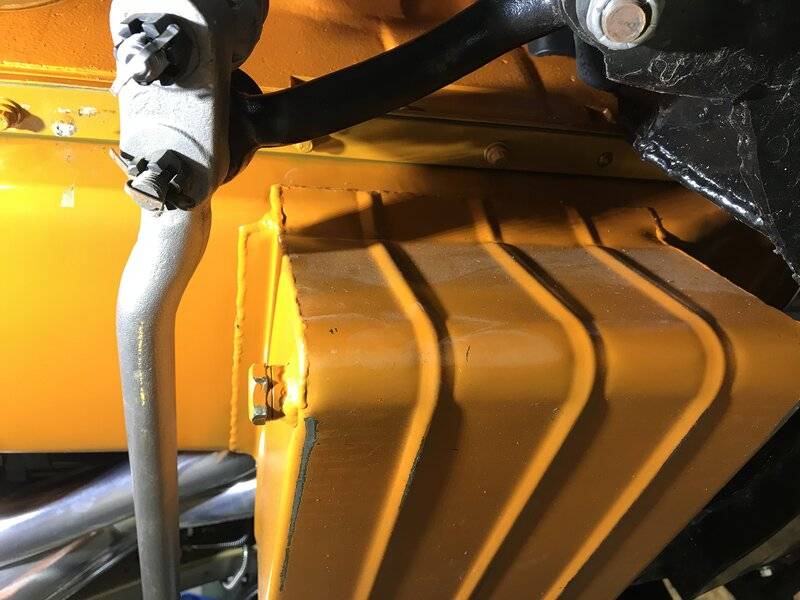

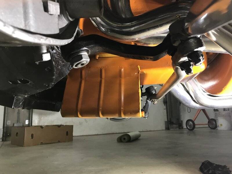

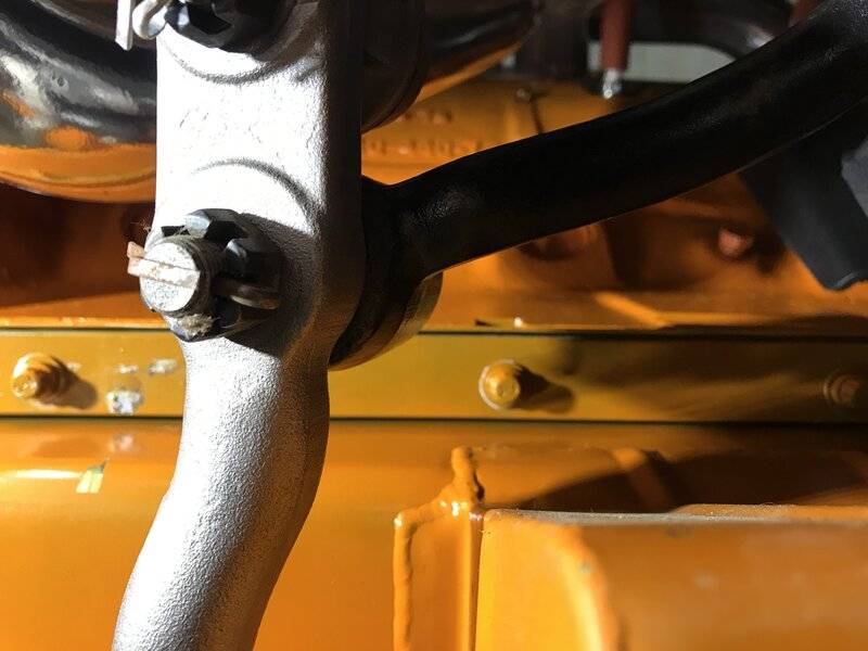

I didn’t see that when I bought the parts about 5 years ago. Here’s some pictures without the torsion bars in. I have all kinds of clearance between the pan and drag link and headers. It’s a morose 7 quart pan flared out at the bottom but not the same pan as yours. It is a little tighter on the passenger side but still plenty of clearance. I took one picture straight up and the edge of the idler is at the edge of the pan. The pan bolt in the picture is the third from the back.

Which headers are those? They clear well.

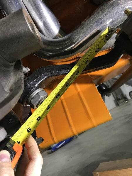

Next time you have your car up in the air could you do me a favor and measure the center to center of both the pitman and idler arms?
Dougs D452 headers RB motor. Everything cleared well until I tried to install the passenger side torsion bar. I did a little research and that seems to be a common problem. Drivers side cleared everything including the mini starter
I can tonight. It’s still in the air waiting on parts to arrive. Let me know if you need anything else measured.

Loosen up the engine and transmission mounts and see if shifting the motor around a bit helps, then lock everything back down. There's usually some wiggle room. I have the factory-replacement style milodon in my car, last time I R&R'd the engine, the link was touching the bottom of the pan's rear surface afterwards....before, it at least had a small amount (like 1/4"-3/8" small!) of clearance. I also noticed the header had previously been close enough to the pass. side fenderwell that it left a small rubbed spot(it wasn't touching at rest, but must have been too close with the engine and body moving during driving). Jockeyed it around and got clearance everywhere it was needed..

Just got done spending 3 hours taking out the motor mounts and shifting the drivetrain as far forward as possible. I'm guessing I got another 3/16" of an inch. Transmission mount holes are now to the end of their adjustment. I wouldn't want to go anymore because of the fan to radiator clearance is getting tight also. Now when I turn full right and with the dent that was already in the pan, I have about 1/32" gap. Without the dent, it would still be kissing the pan. I am going to call it good and remember to never buy another one of those pans.
