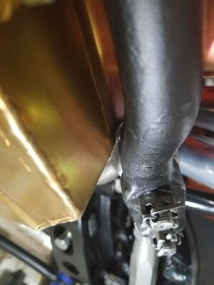

Anybody else have steering link hitting oil pan?
If the sump is not leaking oil I would avoid hammering it. It is only going to be a very tiny problem in car park or a 3 point turn.
The amount of times it would hit are going to be few and far between.

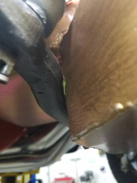

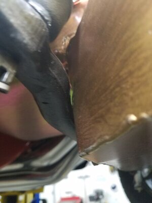

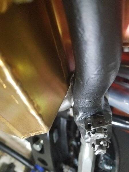

I got talked into using this Milodon 31580 Road/Race 7 quart pan on my 499 build. Full turn to the right bumps the corner of the pan. Don't think I want to dent in the pan because I don't know where the baffling is. Should a guy worry about it?

I would like to just smack it a few times with a hammer. Don't think it would take much, but like I said I am not sure where all the baffles are inside.

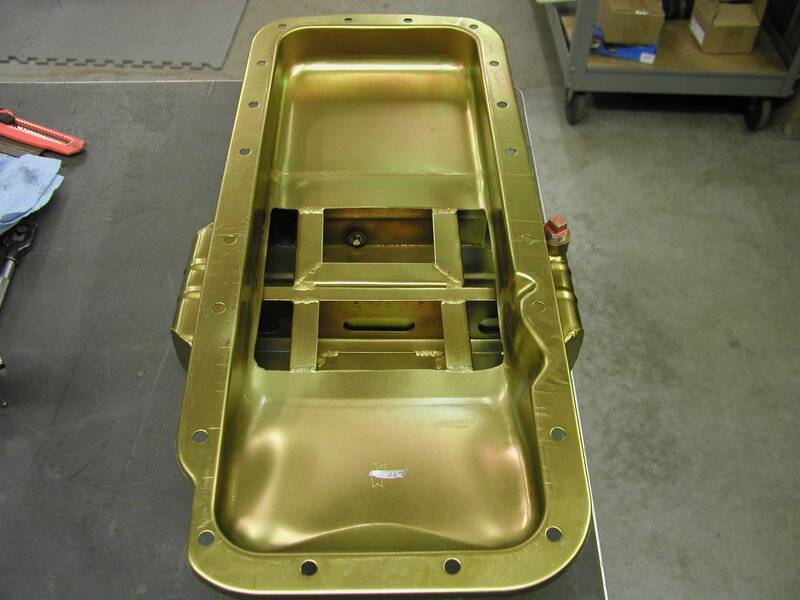

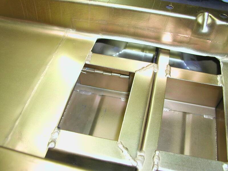

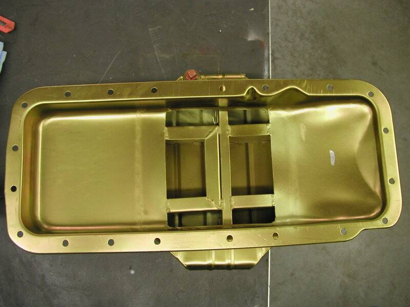

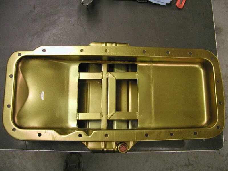

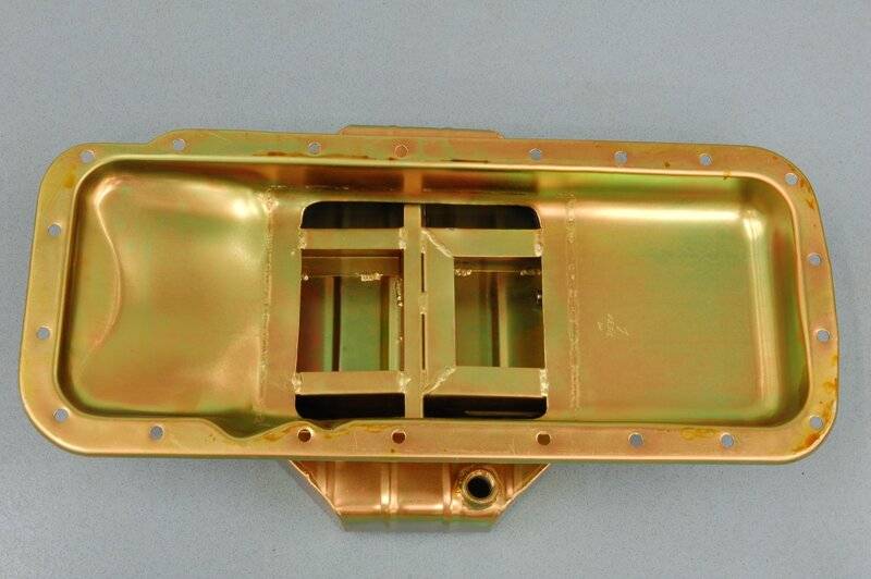

As AndyF said, pics are worth it, never know what will come up later on that a couple photos might help with. Here's a couple more with some additional detail for you. Hope they help out!

I'm not sure how much the C-link is hitting the pan, or is it locking the steering from moving completely and jamming it ? If it is just "grazing" the pan, could you just put some relief in the C-L by grinding a bit out ? I'm not saying to take a 1/4" out, but maybe you could gain enough clearance there, without weakening the C-L...

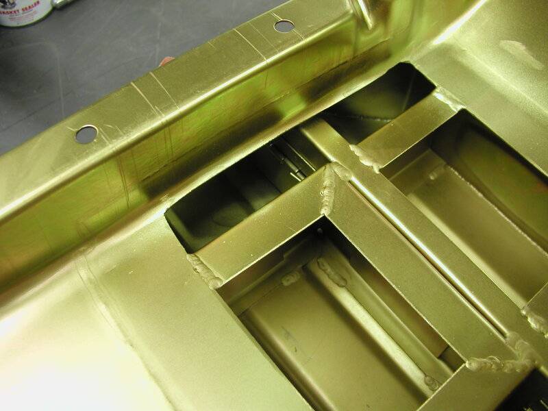

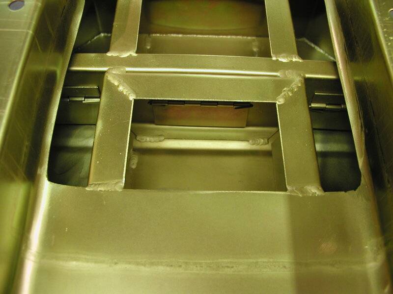

Definitely don't think a guy should be hammering on this pan after seeing whats inside....
I tend to agree with you on that, its pretty well braced from all directions on the inside.

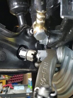

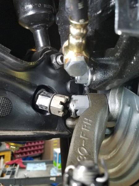

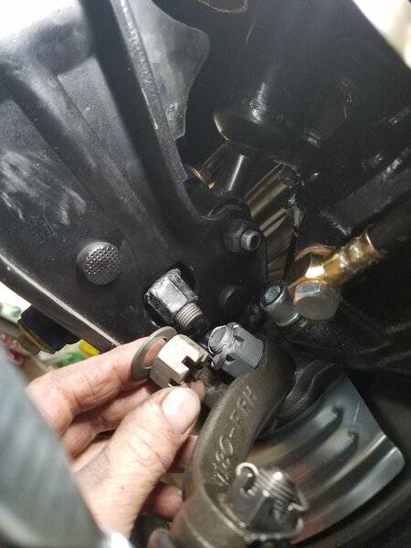

So you guys tell me if this is to "redneck". I can't find any tall 9/16 fine thread tall nuts. I put a thin washer and then a castle nut that I have on the end of the strut rod. With the dent that was already in the pan, I now have a tad of clearance. Probably 2.5 to 3 threads are into the nut. Think I should put a bit of loctite on and run it? Or is it a stupid idea?

Like I stated above, I will never buy another one of these overpriced pos. But since it was like $450-$475 I just can't bring myself to ripping it off and throwing it in the scrap pile.
