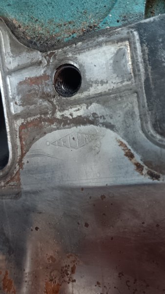

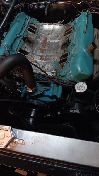

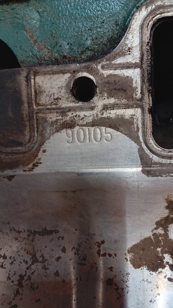

Does anyone know if this is the factory intake gasket for my 1968 Plymouth 383 2 barrel? I'm just curious if this engine has been apart before. When I unbolted the 8 bolts on the intake, it was loose, didn't seem like it was sealed at all. I'm replacing the factory 2 barrel intake and carb with a Edelbrock intake and 1406. After that, a new electronic ignition distributor. If that doesn't get me enough, then I'll install a new cam. The old school, Cal finned hood scoop is optional.
Stock would have had an insulator pad between the intake and gasket

The Felpro name stamped in the pan is a dead giveaway that this part is not factory.

Felpro so aftermarket
