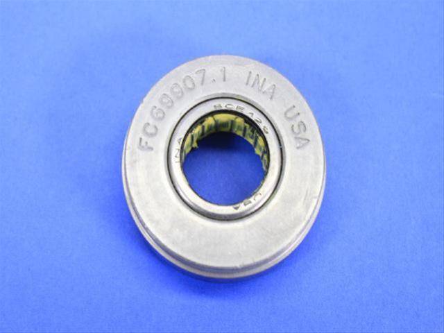

p4876056aa
53009180ab
Here’s a couple of mopar part numbers, one of them should still be good, you should be able to get one of them from your local mopar dealer for fairly cheap. If not other vendors like brewers sells them too. You won’t have to worry about under or over sized traditional bushings this way

Perfect fit and a worthwhile upgrade.
When I originally put my combo together years back, the crank was drilled but not reamed. I made a bushing to fit (turned down), but could not get the run out under .007" I think. I always had a slight vibration with the clutch engaged at higher rpms and wondered if that was the reason.
This year I replaced it with the above bearing, run out .001", and the operation is much smoother, that vibration is gone

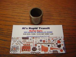

Just to be clear, that's a pic of the bushing that fits the drilled and reamed crank, not the needle bearing referenced in this thread.
Edit: I re-read the first post, and I see that is what was requested.
I think the needle bearing is better though.
