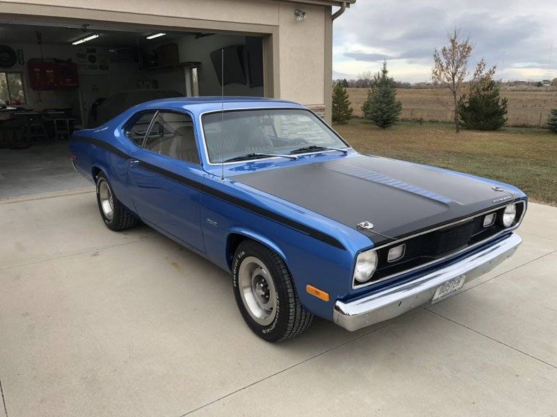

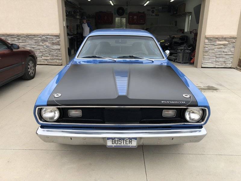

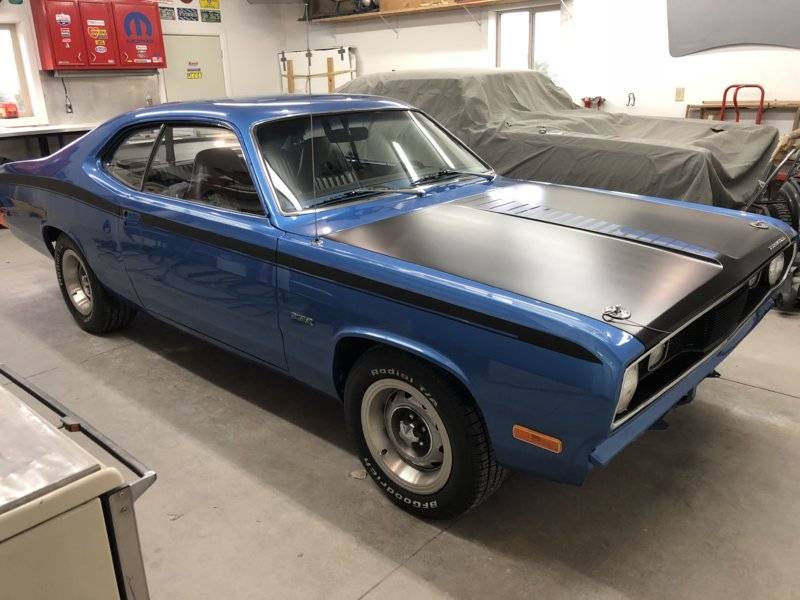

No **** on the tiger stripe. You can see we got a little but it has since settled down a bit as it cures.
I noticed it on the second coat then increased to about 75% on the final coat. Still got a little. It'll do.

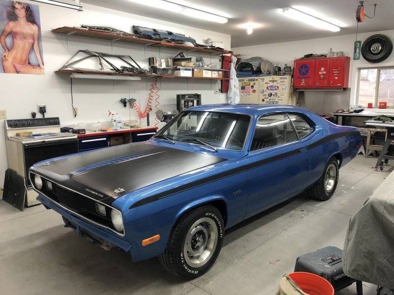

Got graphics on today and some assembly. Will finish it up tomorrow.
Whats under the cover?
Question 1, yes, the matte was single stage, laid down nice but still tiger striped a bit at 75% overlap. As Kern said, shooting matte black is spray and pray. He is right. Never done it before.
Question 2, why my 68 Runner of course, which was put on the back burner (again) for the Duster project.

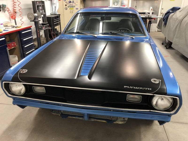

And if you're curious about the hood stripes (Single stage matte over gloss 2 stage), yes there are definitely tape lines. Pondered that one for a bit then said f@ck it. We'll live with it. Driver, not a Barrett Jackson show car.

Yea but I bet you put that ******* Graphic Express hood stencil down better than we did. I have said it before and am saying it again, it kicked our ***.
