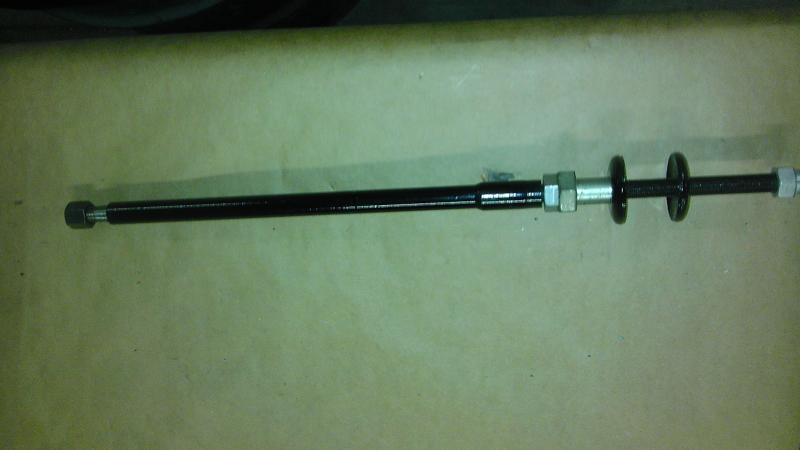

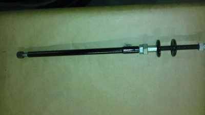

Here is what I came up with. You have to loosen the bushing end but you don't have to loosen the control rod end. You can get an inch of adjustment either way but, by that point something is probably wrong. They are also 7/8" thick so they are less likely to bend. Haven't installed them yet, and it will probably be a while. Was going to go with the heim joint but I have heard stories of K members cracking. IMAG0417.jpg

I just wanted to fine tune my front end. My strut rod was bent and measured flange to flange was around 17" I think. I just want to make sure I can get the lower control rod on center so the A arm can be properly adjusted. It may not be "17" " it might be 17 1/16". Just want to be able to dial it in right not try to force something that wasn't ment to be.

What I'm trying to say is that these cars are old and everything is not perfect and parts wear.(especialy old style bushings.) If you have the means to adjust your strut rods to keep the control arms perfectly perpendicular to centerline why not. That way the rest of the suspension can be properly adjusted. Plus, mine like others i've seen are bent so I wanted something a little more stout.
