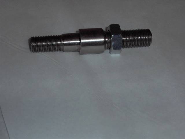

Here is what I came up with. You have to loosen the bushing end but you don't have to loosen the control rod end. You can get an inch of adjustment either way but, by that point something is probably wrong. They are also 7/8" thick so they are less likely to bend. Haven't installed them yet, and it will probably be a while. Was going to go with the heim joint but I have heard stories of K members cracking.View attachment 99188

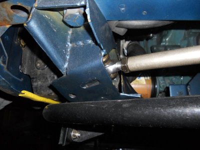

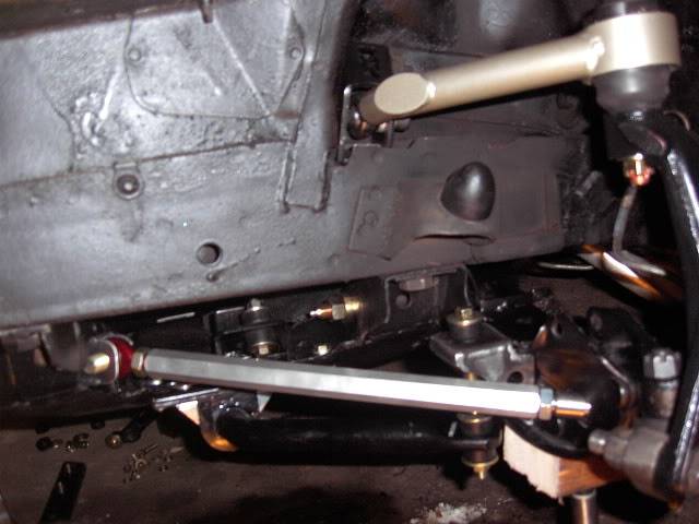

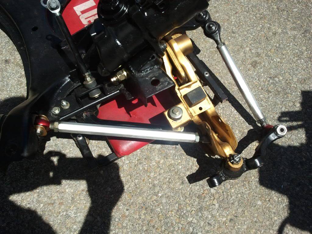

I took a couple pics of the Hotchkis strut rods in my car. The rods don't have a flat spot in the bung by the heim joint, like the P-S-T product. Once you get the front mounted in the K member you really can't turn the joint. The adjustment would be made by loosening the jamb nut and retainer at the LCA and threading the rod in or out. Without a hex or flat spot on the rod, the only way to rotate the rod would be w/ a pipe wrench, scarring the rods. Looks like the P-S-T rods are the way to go, both remove the rubber bushing and have a solid front mount, but the P-S-T rods have provisions for adjusting the length once installed.

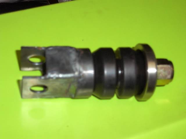

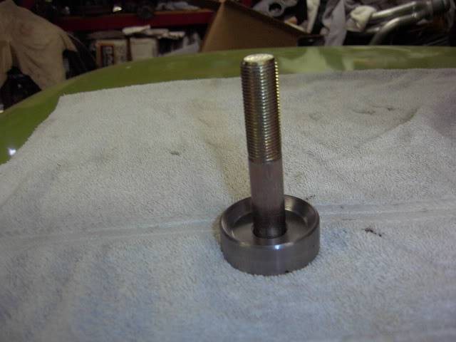

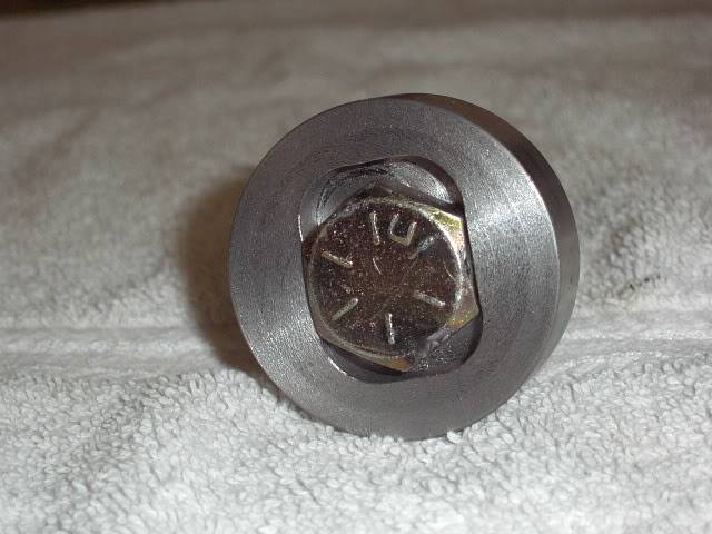

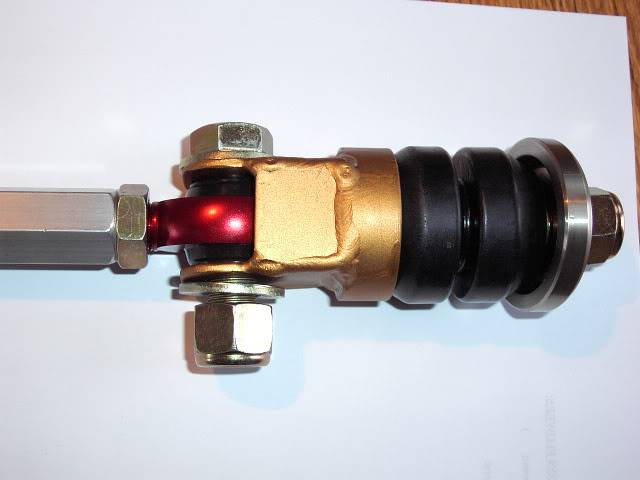

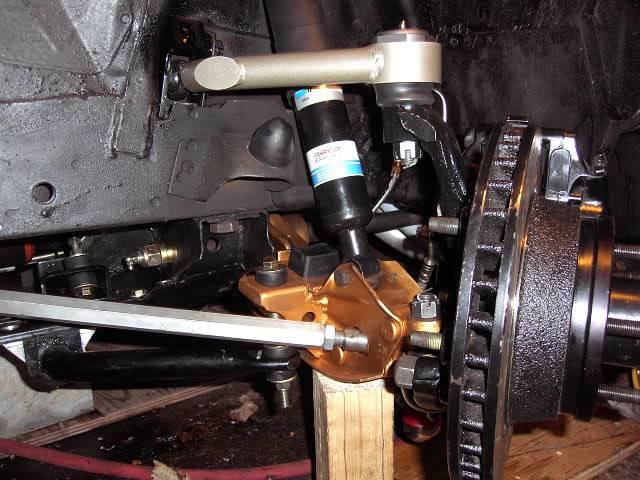

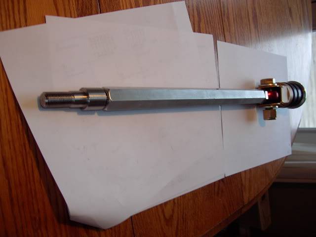

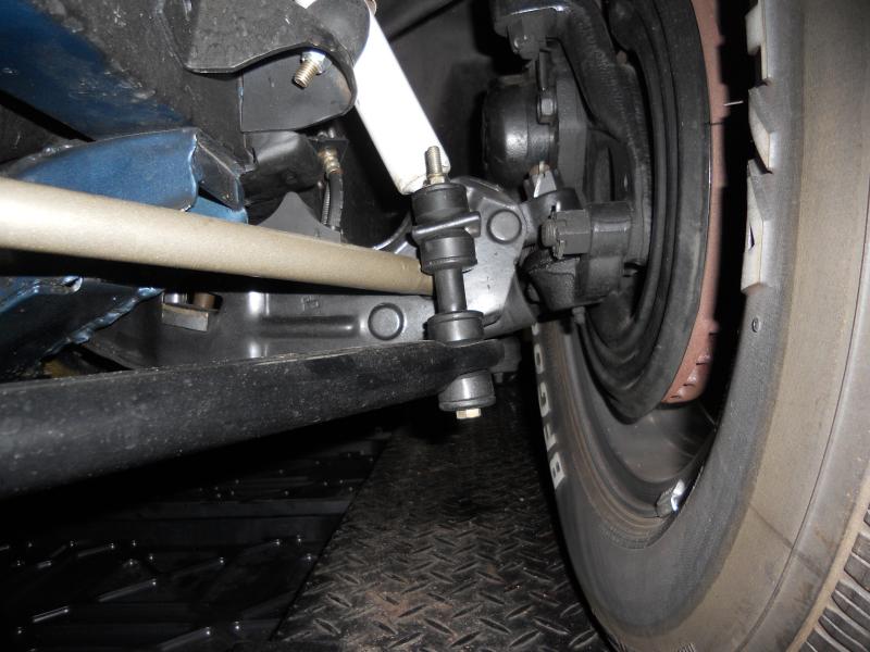

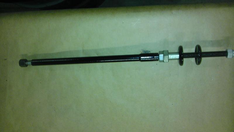

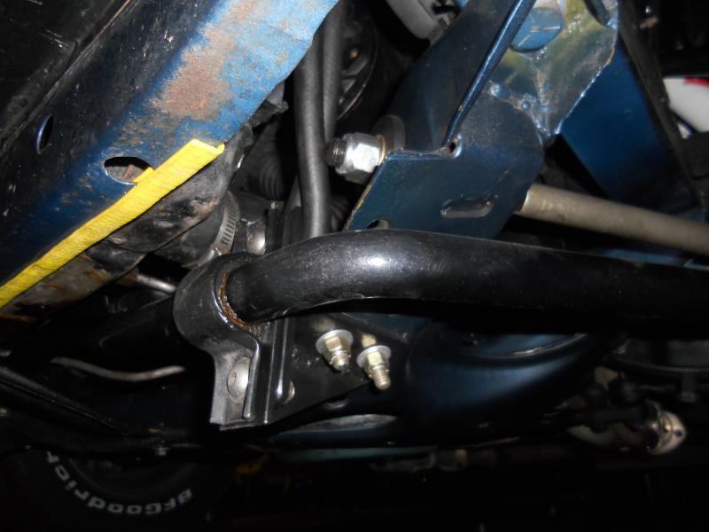

I made my own. I wanted them mounted in urethane to dampen road shock/noise? I agree they should not be used to get more caster but to adjust for the "sweet spot" where the LCA bushing doesn't bind.

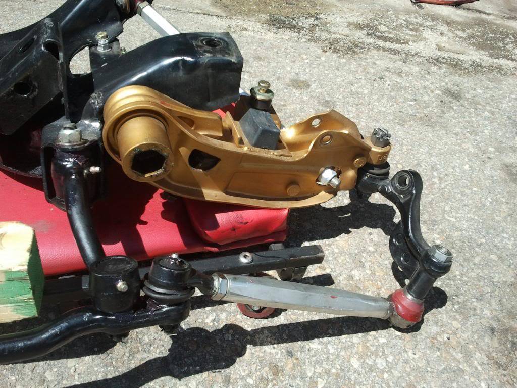

Now those look sweet! I like that it gives the suspension travel/direction what it wants, yet has some urethane to soften the street ride a bit. What car did you install these on and have you driven it yet? I wouldn't mind you making a set for me!
Looks like you're running the Hotchkis UCA's on there as well, which I have on my '68 Satellite. Sometimes when I turn all the way to lock out in one direction at slow speed it feels like something is binding a bit. Would that be my LCA's? I boxed my LCA's since I installed a Hotchkis front sway bar, but my strut rods are new original rubber style made as a one-off for me by a local frame shop.
Damn Brad, that looks nice.
