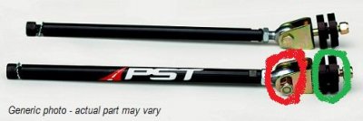

In this picture off your site, Look at the heim joint in the red circle. Won't that relieve the up and down FORCE from the bushing in the green circle? I am almost 100% certain it does. That's a BIG improvement....almost enough for me to get a pair.

yup, you and I are on the same page now. The only thing is the part circled in green is not a bushing its a actually aluminum spacer with a shoulder on one end. So the bushing is no longer needed because of the hiem joint. Thanks for the posts RustyRatRod I think this may have cleared up a lot of questions and spiked a good conversation.
Oh super coolness. I didn't realize the bushing was slam eliminated. That's badass. I gotta put these on my list then cause that eliminates one less thing to go bad. Thanks man.

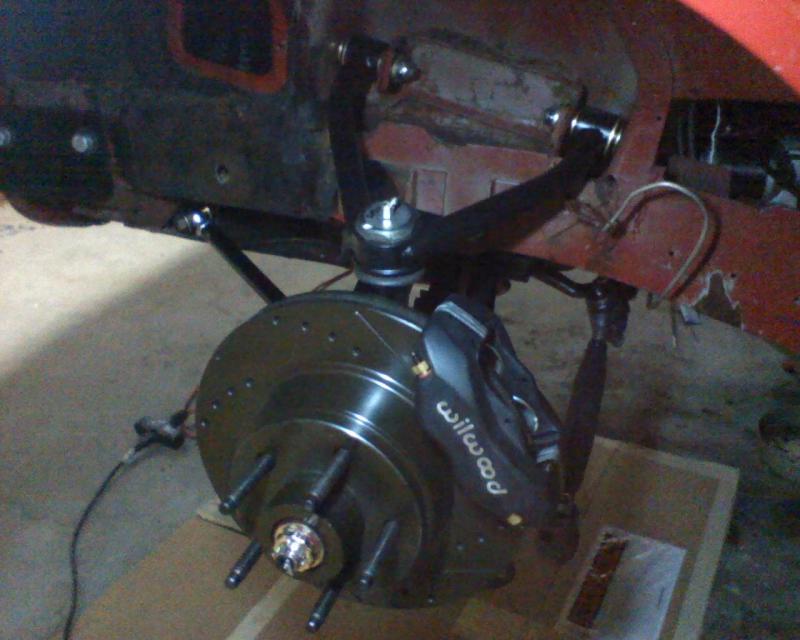

I am using them in my red '66. The purpose behind installing them was to free up the movement of the front suspension. When I had everything together and adjusted sans torsion bars and shocks I could move the assembly through the full travel with one hand.
When I set it down and aligned it I basically set the front cams out and the rears in and had -.5 deg. camber and +4.5-4.75 deg. of caster. This is by far one of the best upgrades I ever made to my car. I used Firm Feel upper control arms, RMS adjustable strut rods, PST wear parts and tie rod sleeves, and an AR Engineering Wilwood Dynalite caliper adapter kit. Oh the rotors came from Rotor Pro's, cunifer brake line from Fedhill, and Fragola Performance for the hoses and -3 to 3/8-24 UNF adapters.
So far so good. Car leaves really nice!

Jeremiah....your rotors are on the wrong side, but looks good otherwise with the Wilwood caliper.
0/2, say what? LOL!!!
Hemi Rebel, Not trying to say your wrong, but, your not right, lol! The "slots" point to the rear, so if ya swapped them, they would be facing in the right position. The pic shows them pointing forward.
The pic shows the left front. What we need to see is the right front. I say the rotor on the right front has the slots facing toward the rear. So if they were to be swapped from side to side the it would not matter. You would be right back where you started from.
Unless they are machined for left and right sides:yes:
lol ok when I go to the other shop I will take pictures of both rotors to see what exactly I did. Once we have clear evidence we will then be able to decide if I am allowed to pick up another wrench!
Depends on how cold it is, lol!!!!
Drilled and slotted rotors do come rh/lh.
