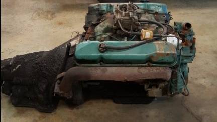

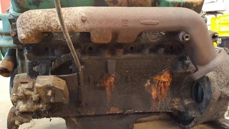

trying to see what a correct bb 1963 polara drivers side exhaust manifold look like.
have the heat soak issue im sure this manifold is incorrect.car had nothing when i got and pieced it back .
here is what it has at the moment
thanks
That’s for a C-body dumping there between 5 and 7.
The dump is further back, don’t recall if it dumps behind # 7 or with # 7. Someone will be along to help

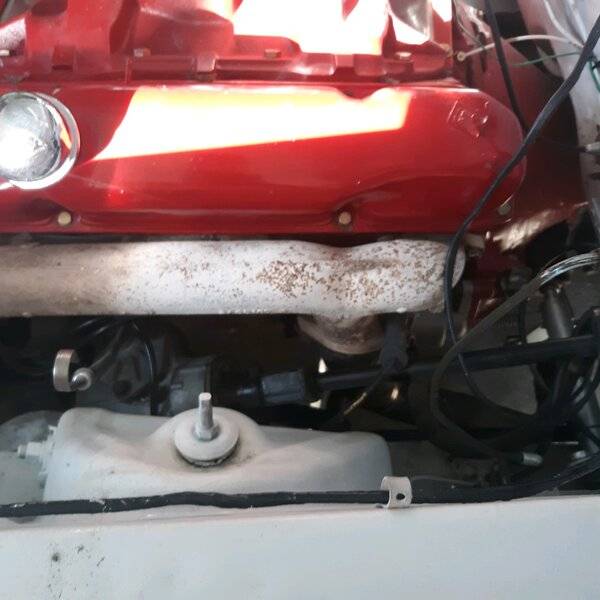

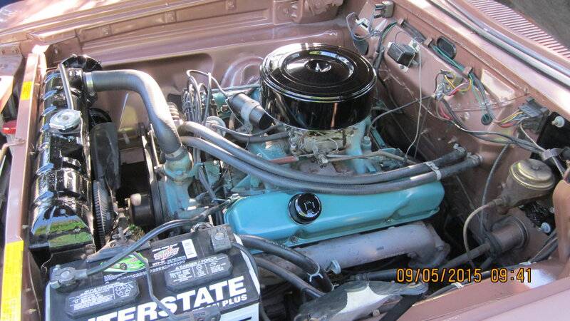

passenger side good,so looks like i need little help if anybody has correct one.
this site is extremely helpful
1962 - 1965 B body Left side 2203262
Right side 2205898
Looks like TTI might make the down pipes for these also.
As an interesting note, there’s a web page out there where these guys built up a 440 from a smog engine and dynoed it each step of the way. They started with these manifolds then switched to late 60’s magnum manifolds. Essentially no difference.
