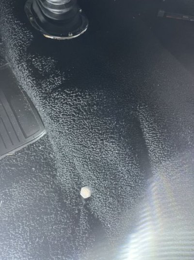

Not sure, but its looking more and more like i got the wrong carpet…. (Came in a box when car was purchased).
Aside from being in a box for 12 years, i tried like crazy to get rid of all the folds and creases to no avail. Steam, heat gun, nothing worked. On top of that, i cant figure out why there’s a molded hump BEHIND the hump for the shifter… see picture. I filled it with foam, but still looks like crap. Original buyer indicated he bought for a 4 speed car. With the hump being a mess, and the overlap between the front and rear pieces does not exist, at best they barely meet up. IMG_6968.jpeg

What i really don’t get…. Is the molded hump (see picture) seems to be too long? The forward part of it is where the shifter is, but at least 8” in back of tge shift (towards rear of car) theres nothing underneath?
Maybe it's not a b body carpet. I think it's all made by acc these days. I purchased 2 acc carpets from rockauto. 1 was a real dud with bad fitment and burn holes. They replaced it and didn't want the other one back. If you get a new one, test fit it right away and have them replace if it sucks.
Im doin something wrongView attachment 1849527
What is that for?
71-74 had two different shifter locations.

I had the same problem with ACC for my 4 speed 67 Charger. I ordered the carpet, waited 6 or 7 months and when I installed it, the fit was terrible around my 4 speed hump. It is really a shame, we pay top dollar for the right carpet from a company like ACC, who claims to be the best, and the carpet does not fit our 4 speed humps.

After steam cleaning and using weights things are looking better.
