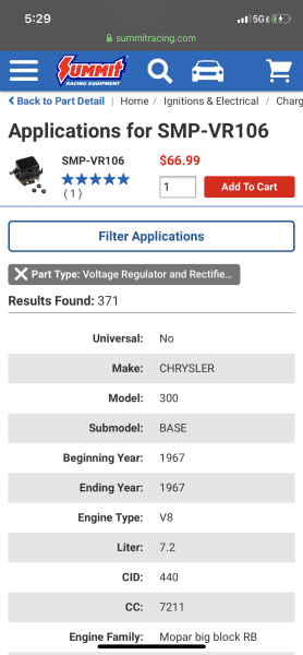

I ordered a 60 amp mechanical regulator from Rockauto, and thought it was a direct replacement. It has a different mounting pattern, and the stock wiring won’t be long enough. I did have a PK41H Fury I Police car that I parted out back in the 80’s. So I might have a similar in the attic. Is it for the optional charging system from the 60’s?
Thats for a GM not a mopar.. Regulator doesn't care how many amps the alternator puts out..
I looked it up. Probably should have done so before posting. But it says on Summit’s site it is for a C or D body 440 with the 60 amp alternator. I had a ‘68 New Yorker and a ‘68 Imperial that I pulled the 440’s out of back in the 80’s. They both were fully loaded with the power stuff, but I don’t remember them having having that box. So I guess they were 35 amp. The cop car I parted did have a big cast iron GM looking alternator. I think it’s up in the attic. That had all kinds of different stuff than the civilian cars. It had a straight through connection for the alternator to the amp gauge with no bulkhead disconnect.

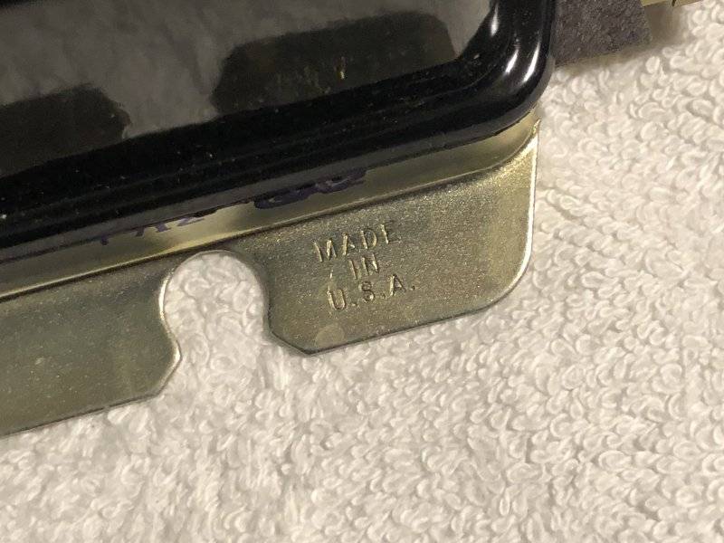

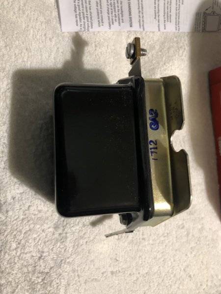

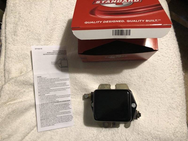

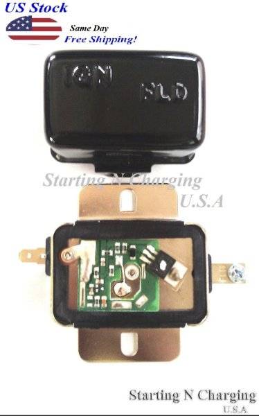

I guess my question should have been... has anyone seen one of those in a B body? Rockauto had it listed for a ‘68 Satellite “6.2 liter” 383. They didn’t list the 440, as it was only available in the GTX for Plymouth that year. The “K” Police Belvedere was limited to the 383 as well. It would work. I just don’t want to drill new mounting holes for it. I have this electronic unit I purchased on eBay coming in on Monday.
I guess my question should have been... has anyone seen one of those in a B body? Rockauto had it listed for a ‘68 Satellite “6.2 liter” 383. They didn’t list the 440, as it was only available in the GTX for Plymouth that year. The “K” Police Belvedere was limited to the 383 as well. It would work. I just don’t want to drill new mounting holes for it. I have this electronic unit I purchased on eBay coming in on Monday.View attachment 1344363View attachment 1344364

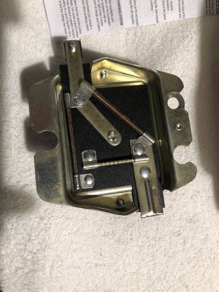

Great choice for a pre 1970 MOPAR. This is the electronic equilivant of the MECHANICAL voltage regulator used on 1969 and older MOPAR cars using the single GREEN wire alternator field connection. The small black square transistor shown on the right side of the second pix, is the switching transistor to control the field voltage. It looks origional but works great....... Just my opinion of course.
BOB RENTON
BOB RENTON
I’m hoping it works! Probably Chinese... but it will bolt right in, in about ten minutes. I did contemplate using the heavy duty one. Then I thought if I’m going to drill for a different regulator, I’d go ‘70 and up like I put in my ‘68 wagon. I had a really clean engine harness I grabbed out of a rear ended ‘70 Coronet 4 door 318 car that only had 40k on it. The front end was perfect, and at the time I thought someone building a Superbird could you the fenders and hood. I went back a week later... and they had run it through the crusher. :(
Agree with post #10. It is an electronic reg [ no moving parts ] in a mech VR case to disguise the look. More reliable/stable voltage control.
