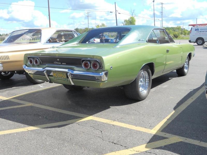

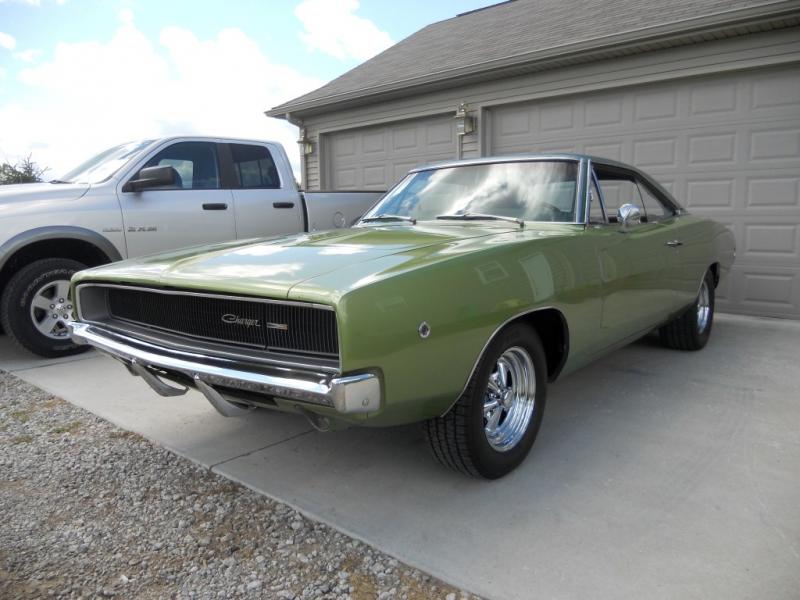

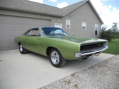

Thinking pretty seriously how my 68 Charger would look with a set of Prostar Wheels
The Cragars look real good but ready for somethig different.
Thinking probobly a BFG drag radial 275/60/15 rear and staying with a 235/60/15 on the front.
If you have any pictures of your Charger with them please post it.
Here is mine as it stands
Thanks in advance.
Mike Z.

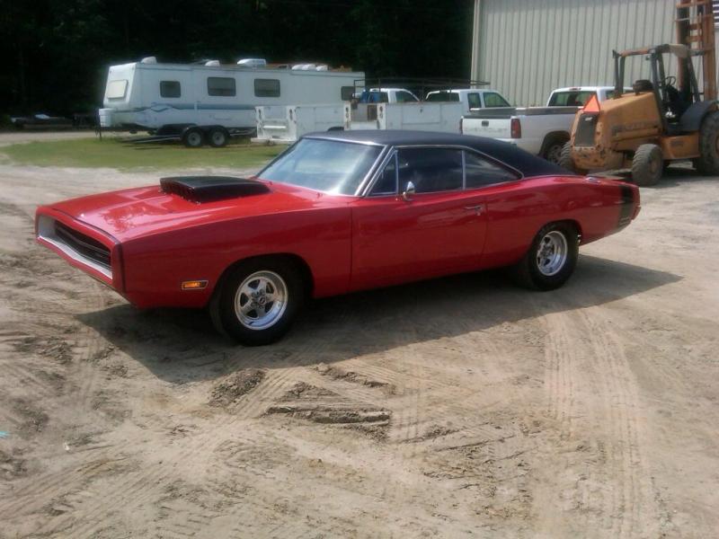

Are these the ones you were thinking about ? They are Weld wheels, probably been on the car about 20 years.IMG-20110617-00006.jpg
Looks great thanks for posting

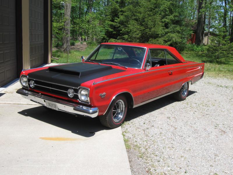

How are you doing with the fit with those wheels and tires? Is it a standard rear or was it shortened? I know it's different but I want to put wider wheels and tires on my '66 Satellite without altering the housing. I'd like to have everything fit under the car without rubbing. I'm just not sure about back space and tire size. Your car looks GREAT. Thanks 383MV
Plymouth 013.jpgPlymouth 013.jpgMy Satellite. 383MV
The Charger is not a all changed from stock.
I have 1 3/4 in to the spring and tub and even more out.
I have a 4 1/4 back space now and a 8 inch wheel
Going to a Weld Pro star with a 9 inch wide with a 4 1/2 backspace
Thats how I figured it
Nice Satellite I like it with the mag 500's
