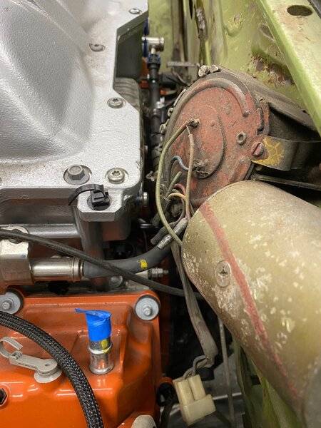

1972 Charger - Got the Hellcat in last night with TKO500 - fits better than I expected, but need additional clearance for the intercooler connection near the Wiper Motor.
Anyone relocated their wiper motor? Let me know what you've seen.

No build thread yet... about time to start one. Working on driveline angle first - have mounts from SST for the tranny that put it at 4 1/2 degrees down - should be somewhere between 1-3 degrees - brought it up an inch - took me to 3 1/2 degrees and that give me an additional 3/4" near the wiper motor. Need to make some cuts to the torsion bar cross member this weekend to get the angle down around 1 or 2, hoping that will give me enough space as there really doesn't seem to be any good options to change out the wiper motor...
Thanks!View attachment 961189

Cut the transmission tunnel and leveled the motor/trans some more - gained me some clearance but still could use an inch.
Deciding now between sectioning the cowl at the wiper motor vs moving the engine forward and the impact that has on some other clearances - will choose the easier of the two.

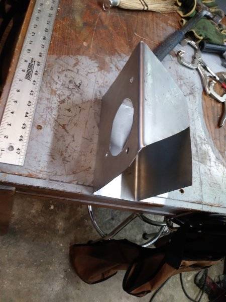

I relocated mine from the firewall of my 67 Coronet to under the dash on the center right side of the firewall. Had to fabricate a weird bracket to hold it there. The arms had to be bent slightly to work freely. Now, my car has a 2004 Audi A-6 dash and console in it and it's wider front to back than a 67 Dash. That left tons of room under the dash for all kinds of tricks...
I basically laid on the floor and had the arms hooked up to the motor and the pivots. Then I moved the motor around in different angles and planes to find where and how the arms moved freely. I then made a bracket to mount the motor in that position. Done.
You can also get a smaller motor out of a few different vans and Japanese cars if room is an issue.
I moved mine to under the dash on the firewall. Here's the bracket I made for it.

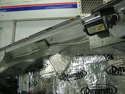

No info - but this was a DC.com member years ago who relocated his wipers to under the dash
The car was later lost to a fire but it shows what appears to be a cable operated system he rigged up?
