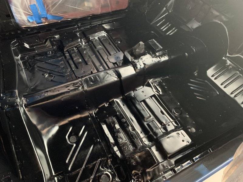

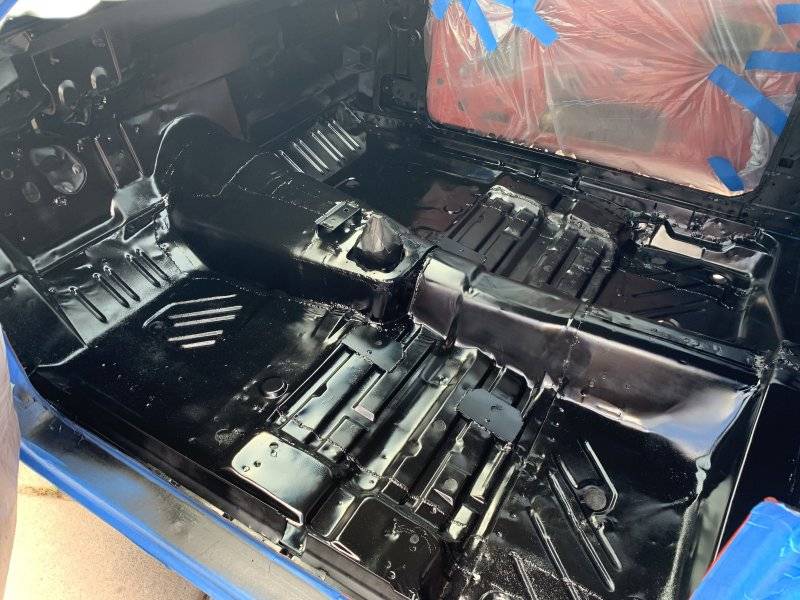

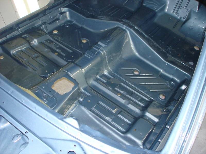

I looked at the factory books and finally found a pic of sorts in the assembly manual and I found a pic online of a guy putting a 4spd hump into a 71 Charger and it showed the brackets.
So, next question is how thick are those plates? I am just going to make some out of 14g sheet metal I think.
14ga sounds about right.
That’s the USCT brackets I welded into my 72. I haven’t mic’d them, but in the hand they felt the same thickness as the 11ga sheet I’ve been using for other stuff. Definitely thicker than 14ga.
