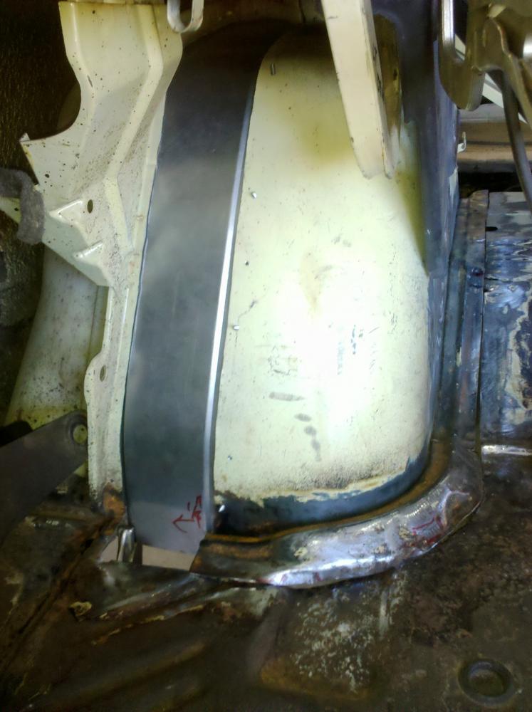

I have the same car. I had a shop do the work for around 1600 including mini tubs. You didn't mention mini tubs. Without mini tubs, you may not be able to run a tire wide enough to make a difference. When you mini tub your car, install the inner wheel tub flush with the inside of the frame rail. Otherwise, the tire will still rub the top of the inside of the wheel well when the suspension articulates upward, causing the tire to move inward. My tubs are flush with the outside of the frame rail, and I will have to have a shop move my wheel well in another couple of inches. This is running a 29 x 12.5 (10.5 W) tire on a 15 x 10.
Mini Tub

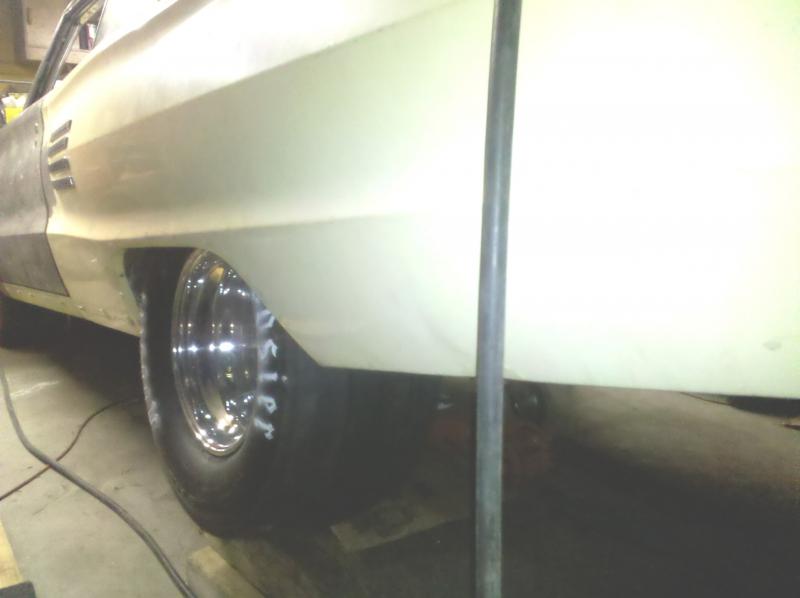

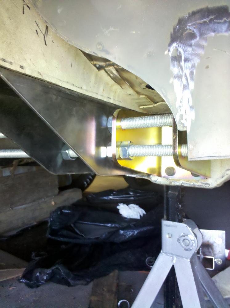

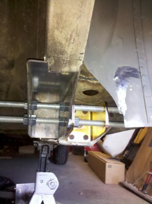

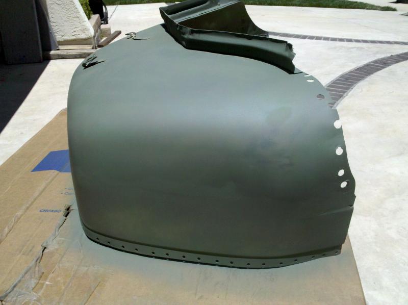

What I been doing, 66' Coronet... but same wheel well...
14.50 X 28 Hooser QT on a 15 X 10, 3400" S/S srings with floaters...
whoops... pics
Pics...

Looks interesting. How does this affect the back seat? Looks like a boatload of work. The wide tires really look good.

When I get done, the trunk will be finished as well trimming the factory mat and looking stock. :headbang:
The biggest PIA is making the fuel tank fit!!! Loosing the ability to run 3" exhaust all the way out to the rear bumper stinks too!
