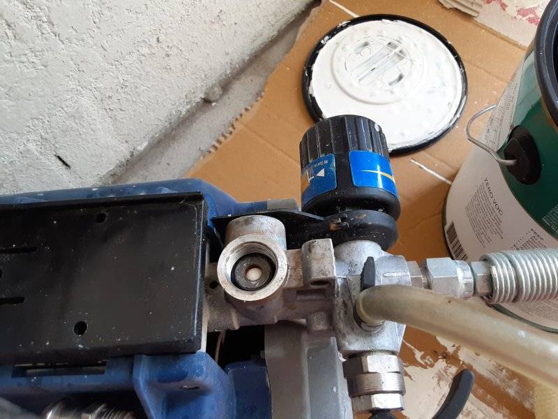

The siphon feed one won't pull anything, even after clearing the rusty debris.
On account of that, I don't think their 4120 kit will work, either.
I suppose I can keep digging into it.
...but we have to be done by the end of the month with only evenings and weekends to work.
Time spent F'n with this could be used for (sigh) brush painting, although I can only stand to bend and stoop to do two per evening.
Edit- guess I do have one more thing to check- the outlet valve. Wasn't sure how to get to that, but just watched a vid.
You'd think it would prime, though.

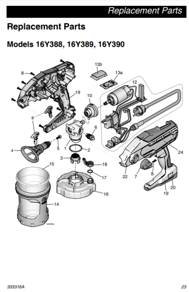

I just found out mine is the "contractor" grade version.
...and they have about 15 different model numbers with different parts diagrams.
Last night I looked at about a half dozen diagrams and only one had the nozzle/pump internal breakdown.
Now of course I can't find that particular manual or even where to get to the place I found those manuals to begin with.
So far, most of the ones I'm seeing have a different nozzle assembly that doesn't come apart like mine does.
EGADs
I need part 5 listed as 17A220.
The only way I can find it so far is in a $160 complete kit, or a $200 assembly containing 1, 4, and 5.
Interestingly they don't show the spring.
This is not my part number. They don't have a manual for the contractor series, and I had to go through 12 of 18 different manuals for the consumer series to find this.
If I had a lathe, I'd make one.
what model number on the pump? Thats the part number,if so I can ask and see if they can get it. I can see what my cost is on the kit also if you would like. Let me know the kit number. When I said your pump might not be clean I meant they are a pita to clean. I feel they always have some paint hiding in it.
what happened to your #5?

This past weekend, I took the nozzle assembly out and found part #5 broken and one coil of the spring mangled.
The model number on my gun is 17A466.
Like I said, I can't find part diagrams for the "contractor" series guns on the Graco site.
The diagram above is from the "discontinued models" on the "consumer" side.
Almost all of the other consumer gun diagrams don't show a part #5.
Of course, there's always the chance that 5/17A220 for that model won't work in mine, but for what should be less than $20 (I know, I probably should't assume a price point) I'll take that chance.

This evening, I'll take the output valve out of the bucket sprayer and see if it's just clogged or rusted like the input valve was.
