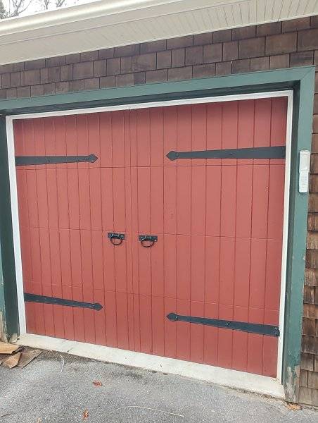

Here's the door in question:

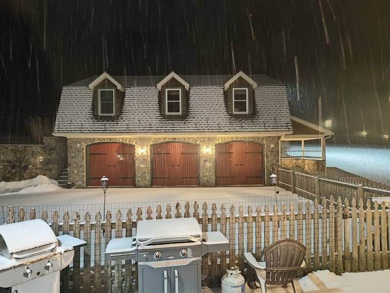

...and the lower level, just because I love my garage...

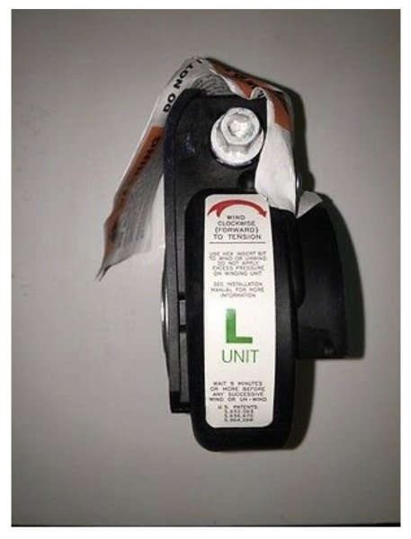

When I replaced mine, I got one from Menards. It came with detailed instructions and the easy winder. Once you get it put together, you just use a variable speed drill motor with 3/8" socket. Not dangerous at all if you read the directions and adhere to them. Here is a pic of the winder.
