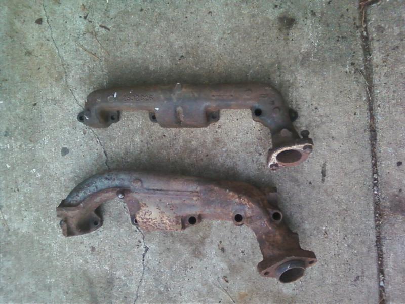

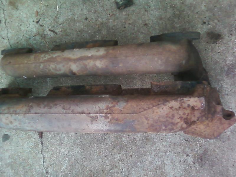

I have a mid 70's 440 out of a c -body. I got to looking at the exhaust manifolds and I noticed how much they look like the hi-po manifolds. They may not flow as well as the hi-po's but they don't look bad. I was comparing them to a 1966 b-body manifold and they definitely look better then them. I fit them on my 67 GTX with a 440 and they fit perfect. Looks like the c-body manifolds may be a cheap alternative to the hi-po's.

If the bottom one is the newer C body, then yes, they do look better. What casting number?

I believe the bottom one came off of a 76 new yorker. I will get the casting # tonight. I'm thinking the c-body piece would be a lot cheaper and a lot more plentiful. They may not flow as well a hi-po set but they don't look bad.

Even though those have a slightly better curvature the outlet seems to be small compared to the hi-po ones from the 60's. For the expense and effort to swap them from the logs I don't think they will offer much, but if you have nothing then I'd say use those C body ones over the logs. Or just spring for a set of 1-7/8" headers.

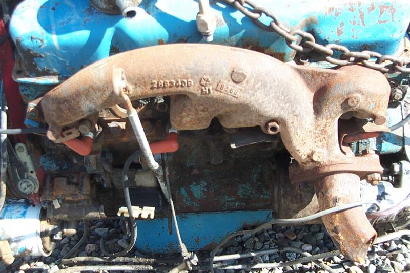

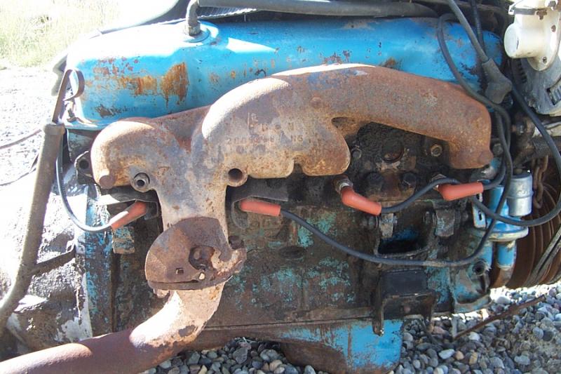

The upper manifold in the pic is just the standard log style. The lower one is the later HP but was also used on LP motors too.
The earlier C-body HP manifolds used the same right one as the B-bodies. The left is real close to the B but has a different angle on the pipe flange.

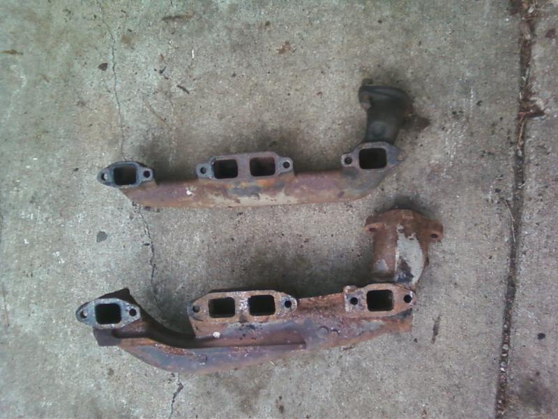

Here is the 69 C HP manifolds. The right brings around 150.00 beings how it is the same as B. The lefts bring around 75.00 which is what I sold it for.
