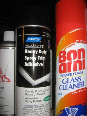

Trim adhesive
This is the trim adhesive ,i`ve always used. It works great.
