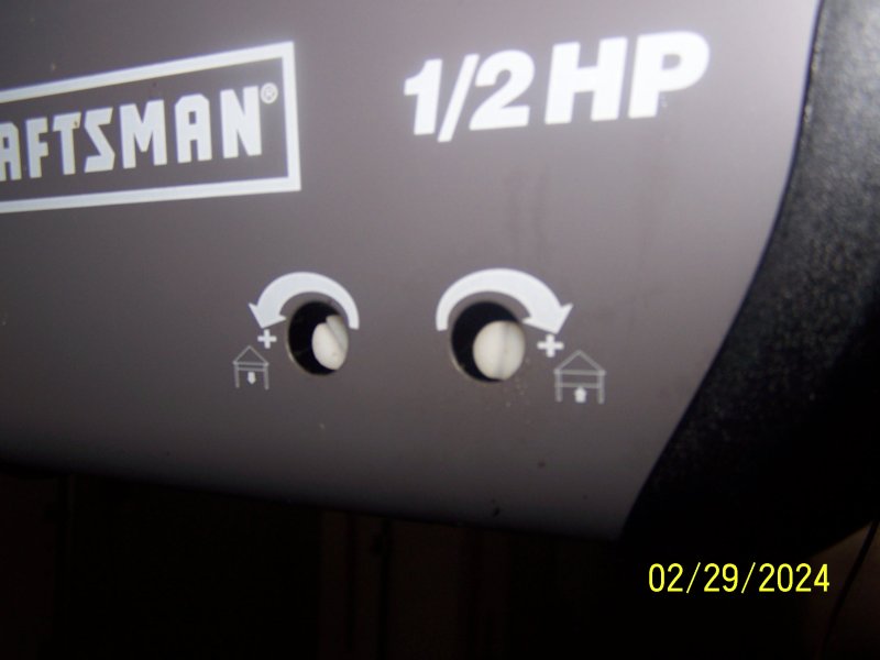

Sounds like you need a different Garage door pro.....My Sears chain driven opener bar bows a little when it get to the bottom also due to the down pressure on the floor. There are adjustment screws for the up and down stops located in the opener housing. I bet all you need is a screw driver to fix it. Do you have the owners manual? I just took a couple pics of mine. The chain has about an inch of sag in the middle of the bar. I doubt if your chain has stretched. Maybe the cable stretched or is in need of some adjustment.

IIRC you set the up/down door stops electronically on install and I've never had to adjust them after initial set. The bar does bow up slightly on full close when the door drives into the ground. It also bows down under load lifting the door, but I haven't had any issues with that. I am still using the original bar (extended version for the 9' door) as I only replaced the motor unit.

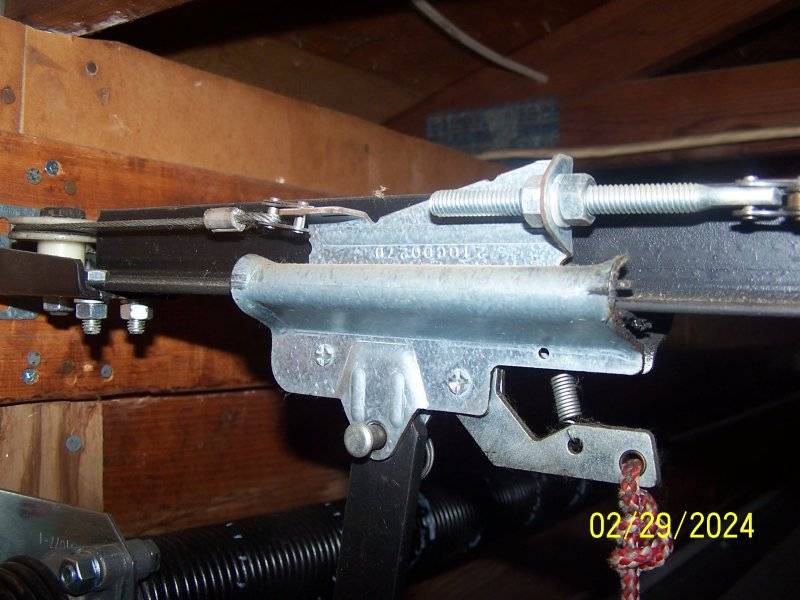

Chain is about 3 inches "loose".
Adjuster would take up about 1.5"
Bar bows what looks like 5 inches...violently.

I've got a Chain drive Stanley that has been working daily for probably 25 years. I had a new Overhead Door installed last year and the installer said it will probably last another 25. Spray a little lube on the tube and adjust the chain when needed.

Wow! a 5" bow.........That is nasty. Must be a thinwall metal tube and not a steel angle bar like mine. I think you are right in replacing it.
It's a "T" shape, but not entirely sure of construction.
We were only there for about 20 minutes, but after I determined the chain could not be brought tight using the adjustment, we decided to call a pro.
