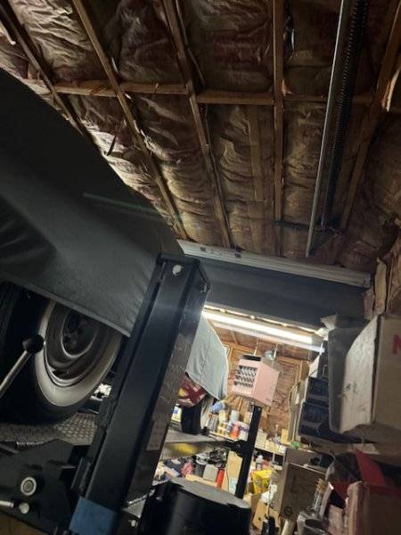

One of my garage doors is a 9'x8' commercial duty wood door, and is pretty heavy. When my lift was installed the track was raised about 2' so the door would go up closer to the 10' ceiling. This would allow the door to clear a car that was up on the lift.
The 2 original springs (the coil type) were not replaced, so that door is extremely hard/ heavy to open and won't stay up. Any opinions on what color tension springs I need?

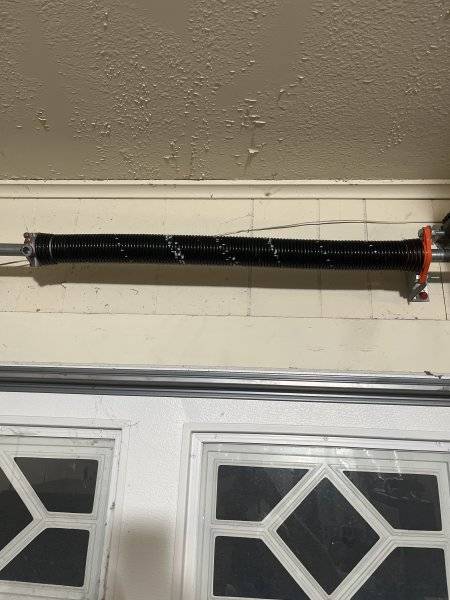

You talking horizontal springs and cable drums, or springs on each side of the door? Top drum style, just crank them up a bit..
Agreed - assuming you have torsion springs (horizontal, above the door opening), just add some tension. Note it will put more stress on the springs and when they fail, you can install heavier ones...but for now it will make the door easier to open.

Ok, I can give you the correct information.
If the door tracks were raised and the springs, drums, and cables were not…that is your problem. You can put every different spring in the world on it and it will not fix your problem.
The issue at hand here is that the door is heavy. This is because as the door goes up each section that passes through the radius of the track, the sprung weight becomes less. By raising the track, you changed the functional dynamic. The springs are set to balance the weight of the door. The drums and cables are. Different for various situations. The flat drums are for standard lift doors. Drums with several higher cable grooves are for high lift doors ( your situation, the added 2 feet). The last type of drum is a decreasing conical style for full vertical lift doors ( doors that follow the wall entirely without going horizontal at all)
With your situation, the only way to fix it is to;
1. Get the proper high lift drums
2. Get the correct length cables. This is a measurement from floor to centerline of torsion shaft and the high lift drums you are using, plus the amount of high lift ( you stated 2 feet).
3. You will need different springs base on the same criteria as #2 calculation.
This is the safe, proper way to get your door to balance. Everything else is just a hack. Do go being cheap. Would you hack or take shortcuts on your car ? Your garage door on your shop is equipment as is your lift, tools and other equipment.
My credentials you might ask ? I have over 10 years working as a commercial garage door installer and repairman. I have done hundreds of these conversions. Get a local garage door company or two to come out and quote the job. It should hover around 500bucks.

They raised the tracks up about 2' and added a straight section to the bottoms. The door is now closer to the ceiling when fully open but it is very heavy and the springs don't seem to be strong strong enough for the extra travel.
Are your springs above the door or on each side. Post a pic
The newer springs have a safety cable inside incase they snap.
Is there any slack in the safety cable when the door is all the way down?
If not then you need a longer spring.
If there is slack then try and put more tension on the springs you have.
It it snaps then you need a new spring.
Go get the longer spring since they moved it 2 ft up.If you try n put more tension on the existing one it may snap. Do as Don said. At lease with the longer springs you will be able to adjust the upward n downward motion of door
