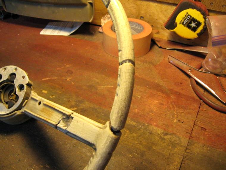

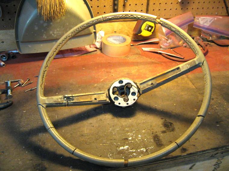

I did my own using JB Weld. Was pretty easy really, it just took a little time. Here's what I started with...
Deep cracks and missing pieces.

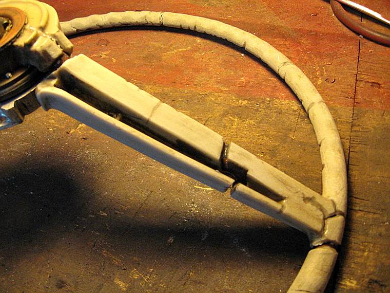

Damage was pretty much all the way around the wheel.

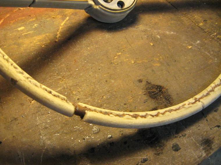

And the back of the wheel.

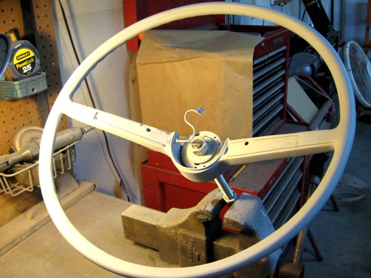

Filled all the cracks with JB Weld which sands pretty easily I might add.

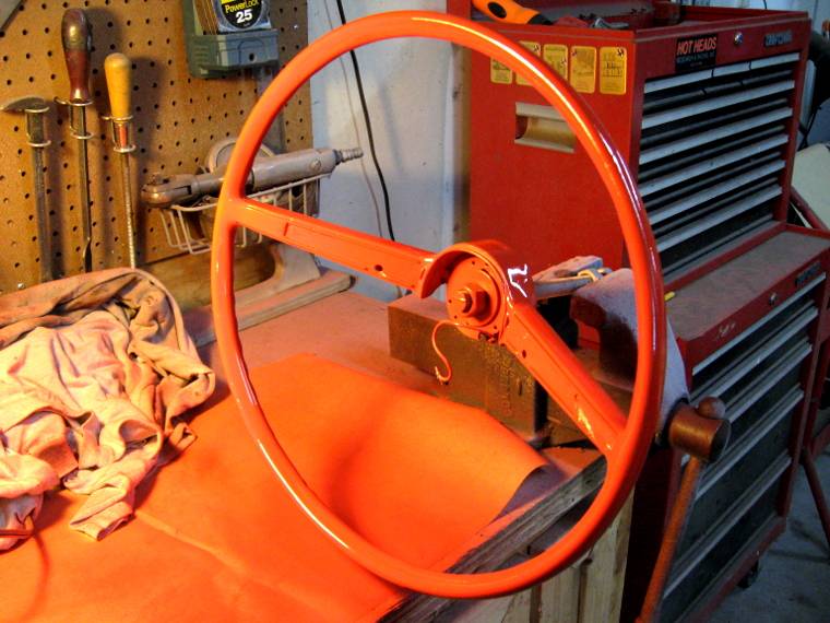

Primed and painted.

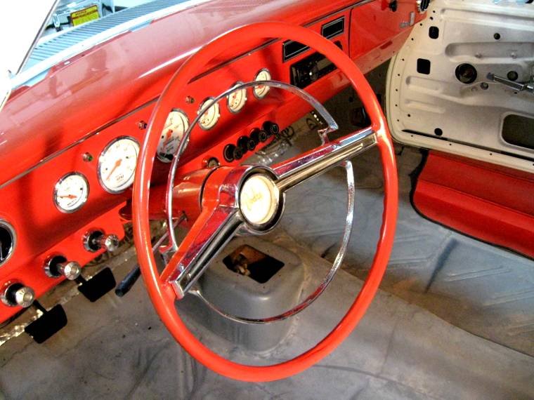

And the finished product. Total cost... under $10.
I think that has to be the worst condition wheel I have ever witnessed! Nothing short of a miracle! Fantastic job!
