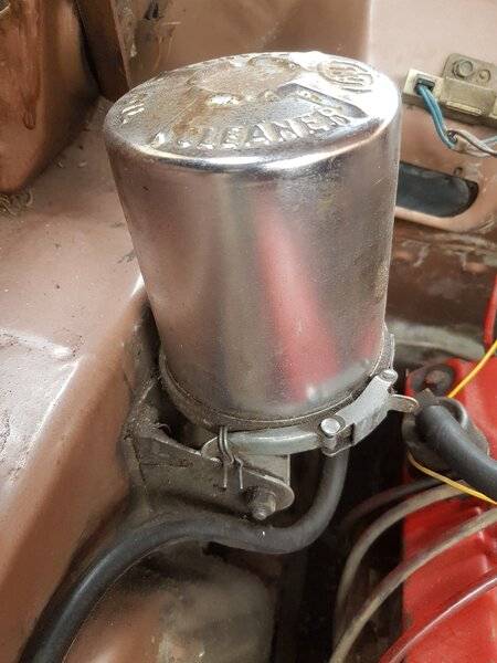

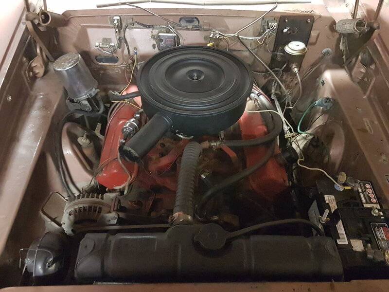

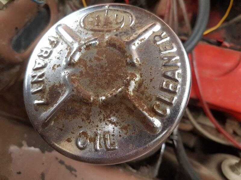

I know its an oil filter. Its in my 63 330. Not sure if anyone know what kind of filter cartridge it would use and where to get.
ss
You tell us. Open it up. Might be a filter, screen, or nothing. I never saw one like that. No info on the outside?
Looks like it is custom. Welded bracket and possibly upside down. Pop it open and see what, if anything, comes out.

None of mine have that, so someone modified it

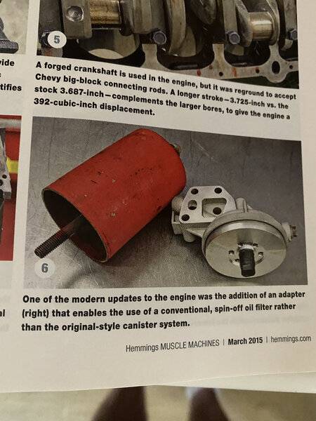

That is a typical "Canister style oil filter" used in the mid to late 50s on some GMs such as Oldsmobile.
Seems someone modified the set-up for ease of access.
Seeing that the plumbing is there, retro-fit a remote system with our filters of today.
Is there a brand on it?

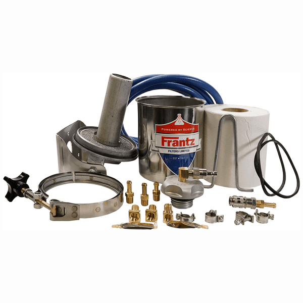

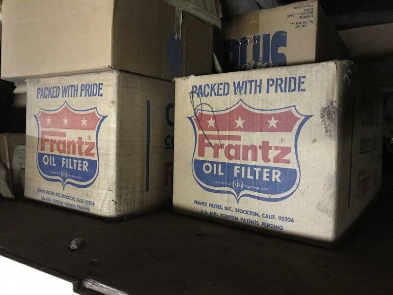

JC Whittney used to sell the toilet paper oil filters?

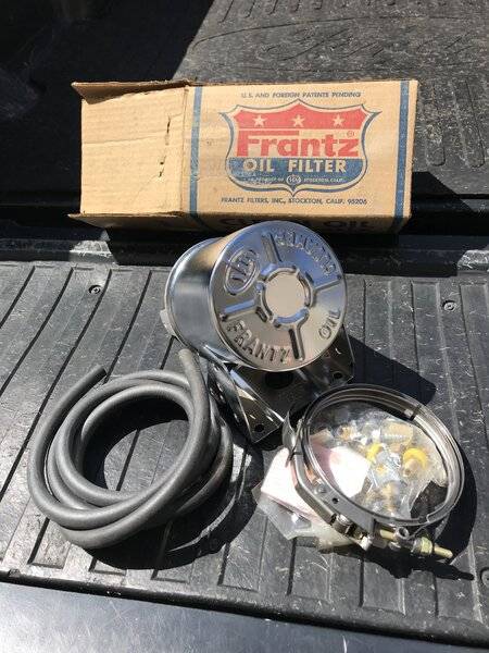

If everything fits correctly inside - correct crush, screen on the outlet, cardboard tube, etc; I'd bet it would be ok for a low performance use with frequent changes. But like any filter, cutting it open after use would tell the tale.
Oh, it's a bypass filter. So you regular filter would stay as well.
