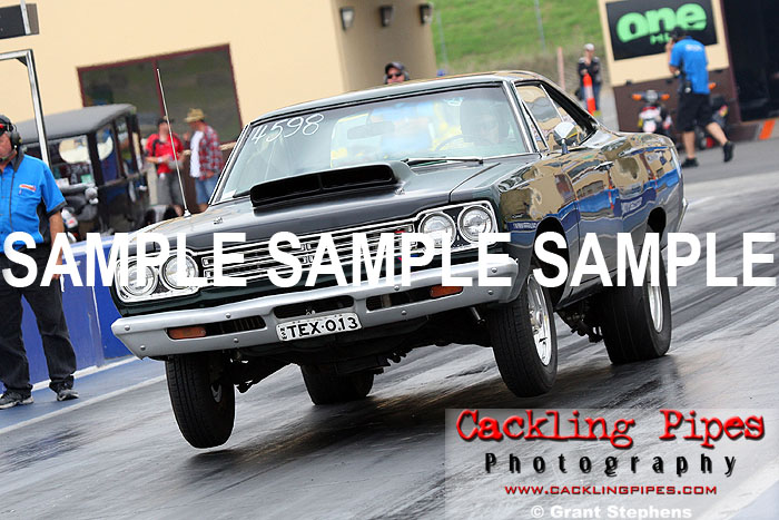

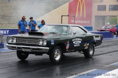

pic

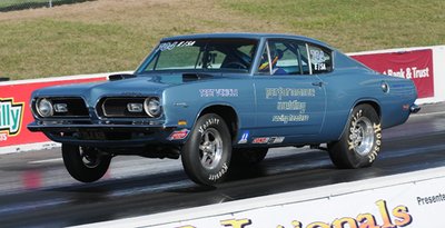

I Love the lift off 6 pack hood cars, your is a 68 thought right? I have many customers in Kangaroo country, Dave Newcombe, was the 1st in the sixes in Pro Stock there using my headers, and half the field in PS uses my stuff as well. I race Stock Elim. D E F /SA with a 69 Barracuda. But I love the old B bodies !!! The guy that takes care of my Big Rig races 6 pack cars, he loves them. Thats what you need is a 6 pack on that car !!!

it is a 68 - just a bitsa.69 grill,70 dash and column
love your barracuda,a friend has a 273 67 model

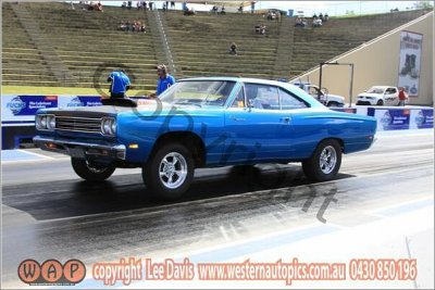

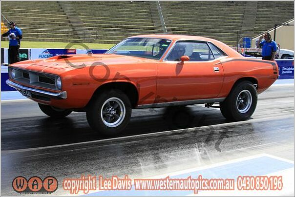

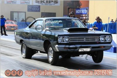

shot on the fast run,Gregs A12 roadrunner,Andrews Cuda
