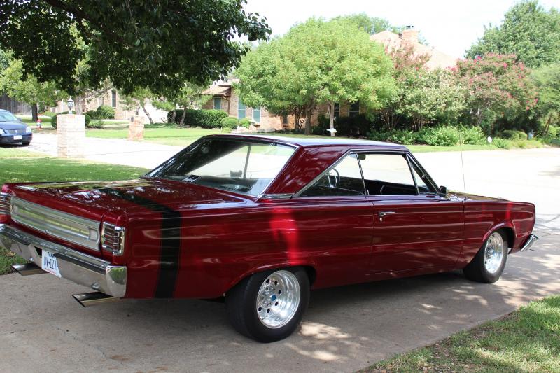

Your main leaf looks very bad. Replace the springs. Get replacement Mopar XHD or maybe the ESPO's like I have. My ESPO's sit low at what I think is stock height. They're for sale, but shipping would be expensive.
Are yours the stock height Epso springs? Have they settled down at all since fitting? I'm thinking of getting the 1" lift (6 leaf) ones that they sell.
That looks great!
