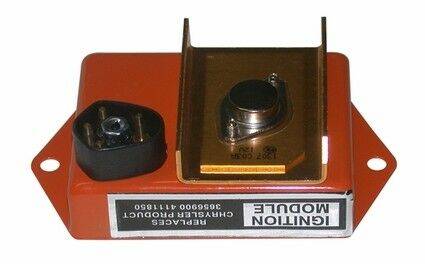

It is not hooked up, just there. Some boxes use a small chip inside and it is full of potting to make it look real. USUALLY the real transistors are marked Motorola, RCA or prestolight. Think you can see it in the pics I have in that link.
Also see a replaces label usually run

Looking for a pic just a small circuit board and it does not use the case mounted transistor.

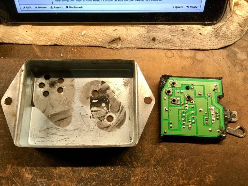

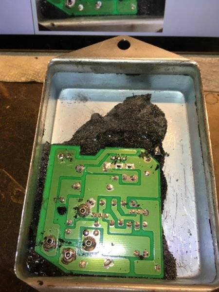

I posted a couple pics above. The potting material has silica mixed with it and the board doesnt touch the heat sink at all. They are there for looks only. Also why they burn up. No heat dissipation.
