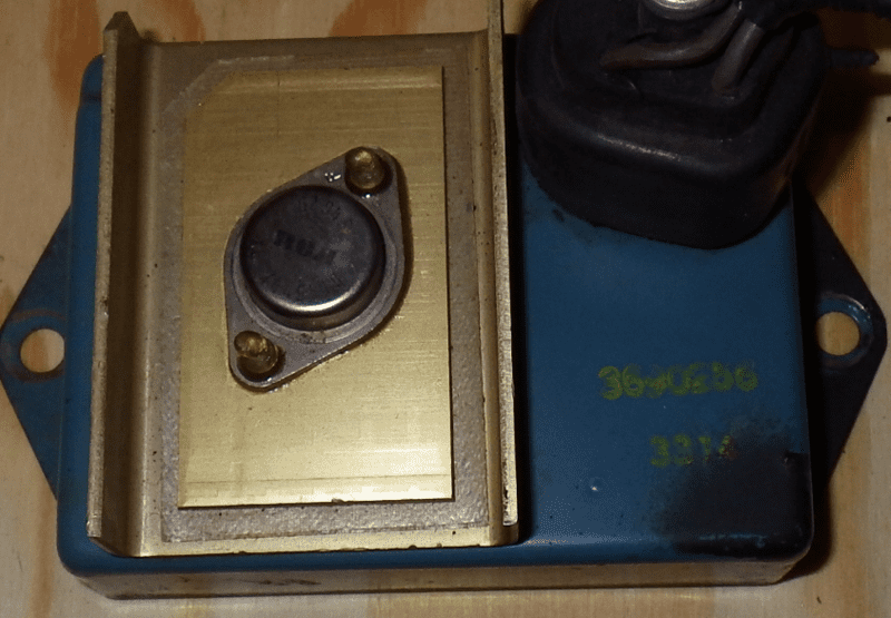

An old Mopar Blue box with the Gold heat sink 3690256 (8000+ RPM) is excellent FAR superior to the common orange box. The tan caps with brass contacts are better than the black with aluminum contacts.

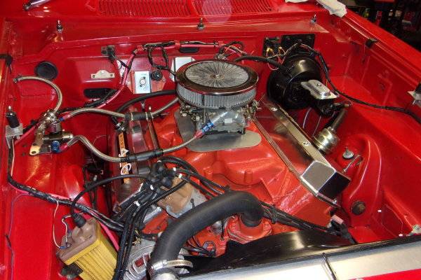

Here is what I can tell you about my orange MP ECU you see here on my car. I bought it in 1999 and had it on my sons Dart until about 2006. It has worked flawless all these years and I still run it on my 63. My son took it off his Dart when he got MSD and we put it on his Dart. Well his Dart ran the same et and mph and started the same with the MSD as it did with this orange box. So I put it with the Acell Super coil on my 63 in 2006 and its still going strong. And about 5 years ago I decided to take the ballast out of the system and just bypass it because I heard some guys were doing that with the Mopar ign and it was working fine. Well its been running about 5 years with no ballast and working good with just the Acell super coil and the orange ECU. After I ran the car about 1/2 hr after I took the ballast out I felt the coil and it was not hot at all as it was nice and cool. So I felt it was not to much current through the coil and heating it up and it has not been as it works good with this setup. The car never misses a beat as it has run 10.70's like this and I trap about 6400 rpm and it is working great at 6400 rpm. Ron
