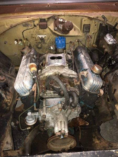

I’ll check the new harness. Oddly enough, my car has two ballast resistors and points ignition...I was a bit perplexed.
Will it matter what coil I use? I have a MSD Blaster 2 for the car.
Depends on your intentions for the car. If just a driver and fun once in awhile, I would stay with an OEM/OEM-Spec. coil. Review the info. on post #4 (page 1) and post #8 (page 1) for general direction if you're wanting something more.
I’m not doing anything crazy, has aluminum intake, headers..possibly cam, electronic ignition...I got the Blaster 2 and Streetfire plug wires as well.
