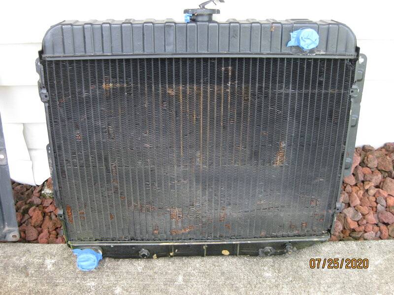

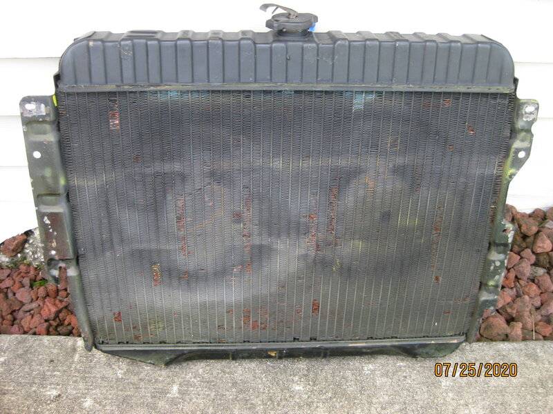

Chance to buy a C body radiator for my ‘70 Belvedere. Is it a simple swap into a b body? Had a 26” and the C body is 26”.

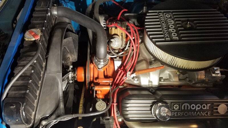

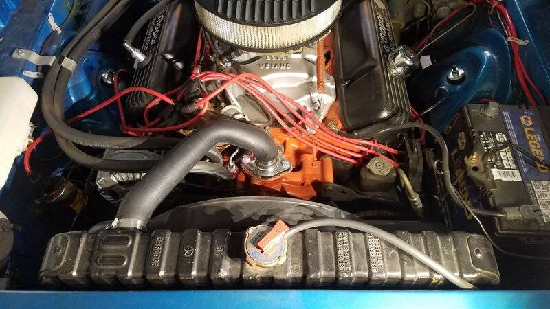

Actually paid $75 for it @ Carlisle about 4 yrs ago with the shroud(brand new re- cored). People see that it's a C body n walk on by......
Keeps my 11.5 CR, 460hp 383 cool in any temp all day long.
