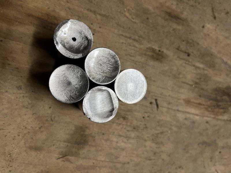

I had a new Comp cam fail. Bad lifters? Not sure what went wrong. Can't blame it on the cam when 5 lifters also took a hike. So either or could have been the culprit. I probably posted that it was the cam and that's pretty much wrong of me to blame the cam alone. 50/50 could have been either one.

what can happen with soft lifters and then there's the problem with all of that crap
being slung throughout the engine. If that were my cam and lifters, I would take
them to a machine shop that can measure Rockwell hardness and have all of the parts
checked. Then I would call the manufacturer and ask what their spec's were. If they
differ any great amount, you should be able to use their own info to hang them!
