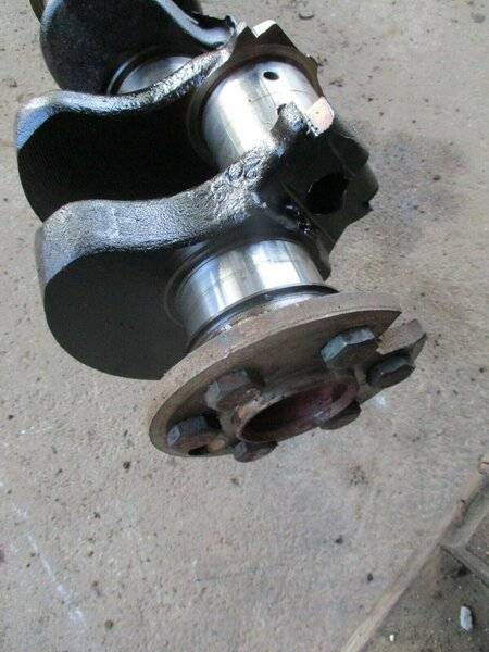

Looking on the Rock Auto site, it lists the Fel Pro 40240 rear seal kit as the same for both series of engines. I thought the B series had smaller main bearings. I guess they shared rod journal sizes and rear mains too ?
Yes it is. The bearing surface for the seal is not contiguous with the rear main journal. :). A bigger question is, which seal kit is the best????
Yes the Slant shared the same as the Big Blocks. Tough little buggars !
The extra seal pieces in the seal kit are for the Slant and not used in the Big Blocks.
