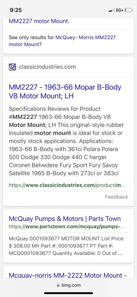

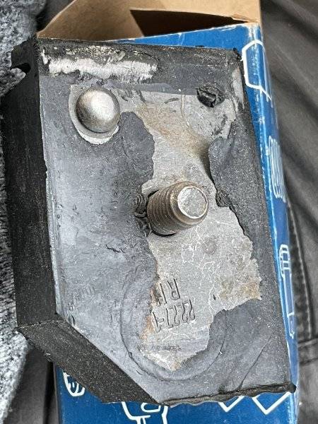

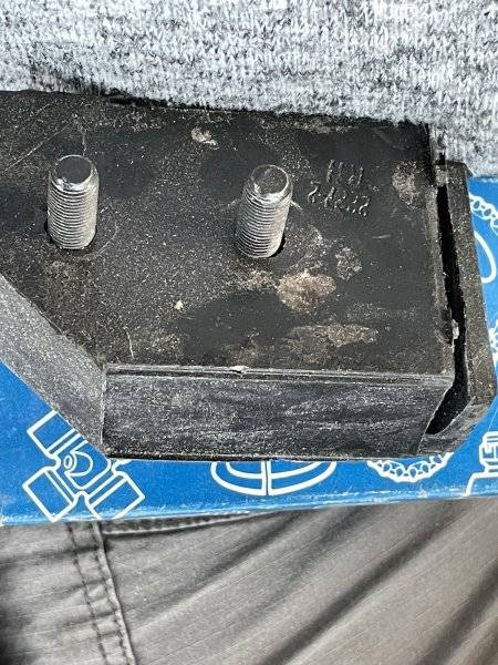

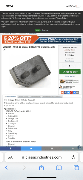

These are McQuey-Morris MM2227 and were given to me by a friend. I researched but couldn’t fine anything.
They are marked RH, right hand.
The friend thought they were Mopar, that was all I had to go on.
Some early '62's did not use these mounts because the early crossmember had a flat mount instead of "V" mount. I think they were like '61 and earlier mounts. The '62 Dart I had was like this. But, maybe a Canadian thing?

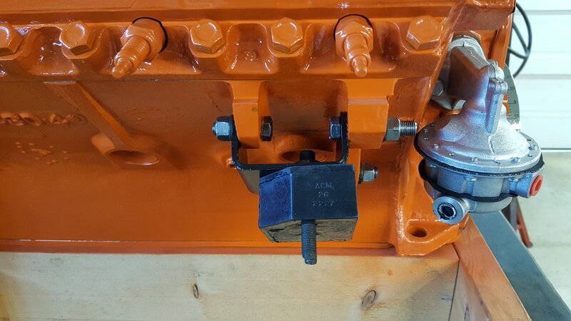

Would the flat mount be 318 specific? These mounts are for the Big Block.
66 to 72 B and C bodies, and 70 -74 E bodies used the same insulators. Right, left, big block. small block, all the same. The steel engine brackets were different between small and big blocks.
