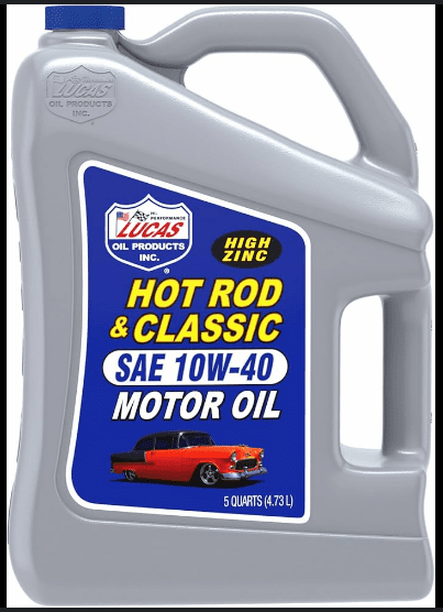

I will be.
Currently using the Lucas oil.
Because I have low miles on my recently finished Runner restoration.
I'll use it the rest of this year and then will be switching over to the Amsoil Z-Rod oil.
My 360 engine has a solid cam (Isky) and needs all the zinc it can get.
Both oils have plenty.
I want to ensure the Crower lifters I have in the engine are doing their job and rotating as they should be before making the switch.
