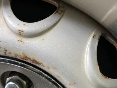

I see the Krylon Dull Aluminum is a metallic paint. The existing paint on the wheels on my car and the junkyard wheels don’t look metallic. I can’t see any metallic particles in them..
The first pic is a wheel on my car. The second pic is of a junkyard wheel.
