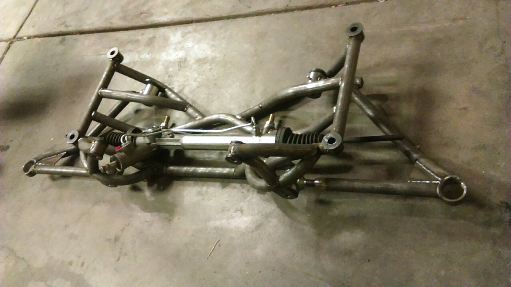

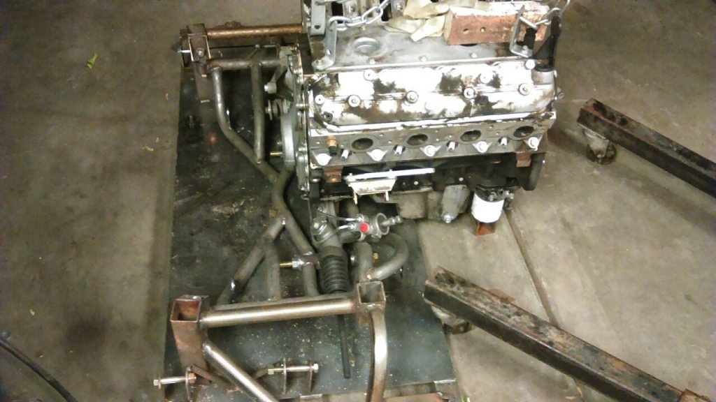

Here's my version of it. I own an RMS I bought for my other car. His K-member design wasn't going to work in this car so I made one.
I should have the A-arms done shortly.
The center beam is shaped to clear the forward turbo headers.

I have no drawings of it, sorry. I used a factory K member to get the spacing and just centered the end rails on it. I used a bent 1/8" wall 2x2 because I have a friend who could bend it for me. My RMS is made of bent square tubing just like this. I just moved the rails out to clear my headers. I'm using Mustang2 spindles from Speedway. I ordered the ball joint rings from there too. I'm modifying the spindles by welding on my own steering arm as well.
