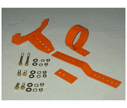

I have one in my car if you run slicks you need a loop summit sells them for 25 bucks and install it six inches past the end of the trans
I put one of these loops on both my cars. No drilling required. Bolts to the trans cross member.
http://www.manciniracing.com/mabebofrdrsh.html
