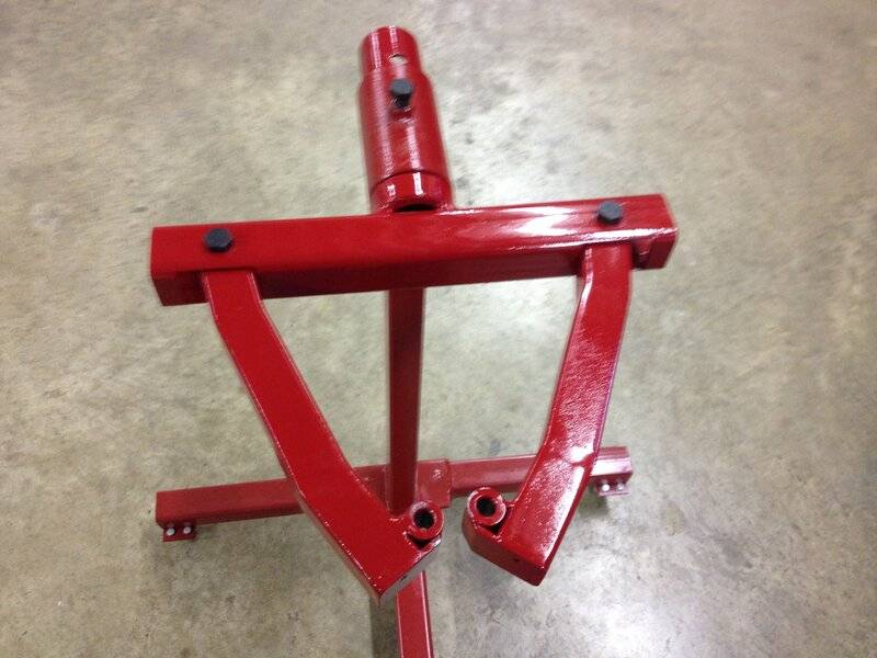

Going to rebuild my 727 and I have seen several videos with a mount that goes into a rotating engine stand. I have looked on the interwebs and I’m not getting anywhere
All the stuff I found on Summit/Jegs is for GM and it’s not rotating
Does anyone know where I can find one?

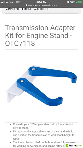

Hmm I don’t know if any off hand, it’s a great idea. I used to take and set them in a clean grease can tail down and pull as much as possible then on the bench. I did see that OTC offers one online.

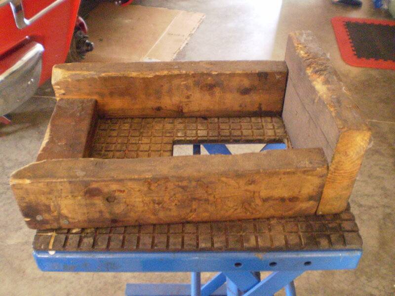

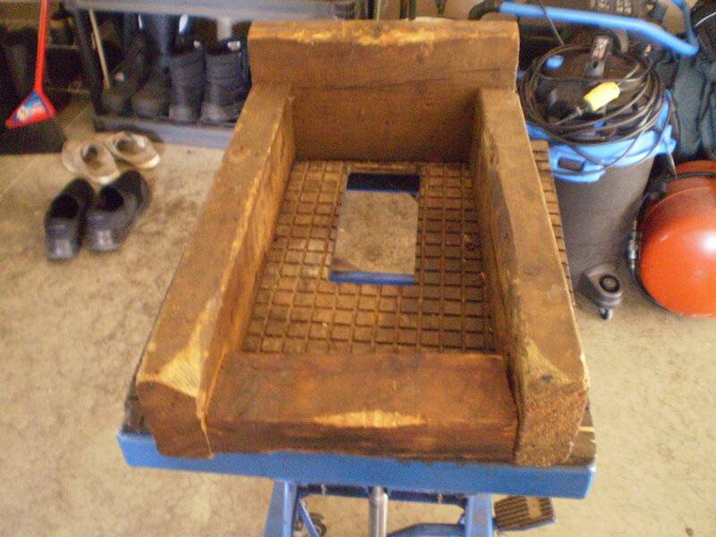

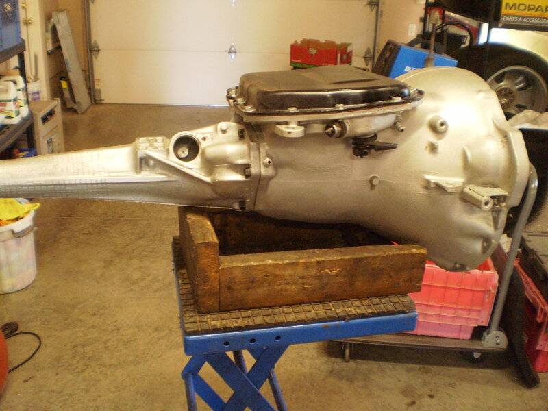

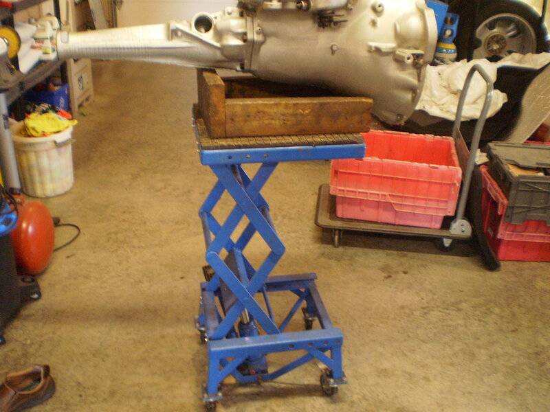

Here's something I made up out of scrap 2 X 4 and 2 X 6 wood. It's not pretty, but it has worked for me for 30+ years. The blue dirt bike lift was purchased at Princess Auto (like your Harbour Freight), and has been a real back saver to lift transmissions up to my work bench.
