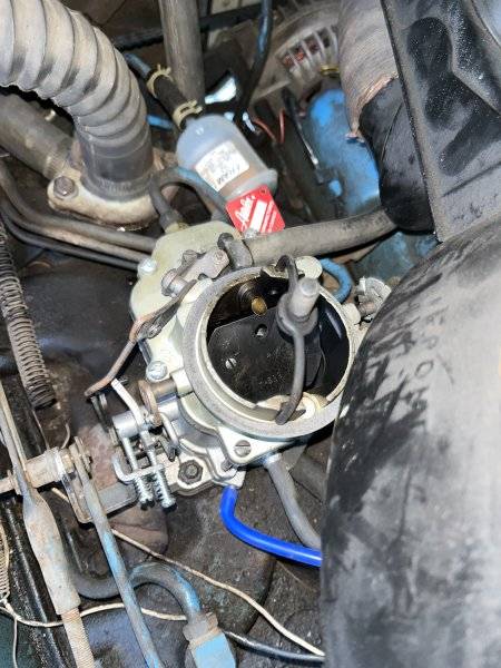

WHO OR WHAT IS AN "AUTOLINE" CARB?? specific model C6023 as referenced. Who manufactured it.....its not OEM. What happened to the origional carb? The pix only shows the air filter canister.
Researching AUTOLINE....they are nothing more than a rebuilding company.......The C6024 is a rebuilt CARTER 1-1/4" BBD carb. The Autoline site lists the standard boiler plate wording: quality parts, cleaning, assembled with care, plus the warranty, its nothing special....just a std rebuilt carb. You would be better off having the origional carb RESTORED by a professional rather than an unknown rebuilder using any/all available parts....which are usually non compatible by origional application....and in this case, likely misapplied.....just becsuse it physically fits doesn't mean it will function correctly.......just my opinion of course......

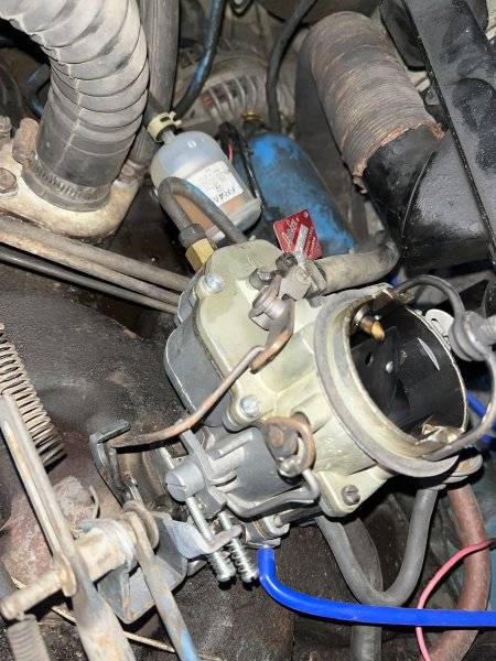

Hi, thanks for your input. I’ll post a picture below. The camper didn’t come with the original. As far as I can tell… the owner previous to the one I bought it from did a major tune up with plug wires, dust. Cap rotor etc and a rebuilt carb. It seems like they slapped it on and got it running.
Engine runs like a champ minus the bog (my experience with carbs have been mostly SU’s in minis and msg) so this is new territory.
So far I’ve triple checked all bolts, vacuum, mechanical advance is clear and working etc.
I’ve now dialed it in to idle at 800/850 when warm and 1000 at cold start up (Fast idle should be set at 1700 rpm?!? Says the shop manual)…. Shop manual also says this should be kicking around 750 rpm at idle but it starts to sputter anything lower then 800… sometimes it’ll just stall if I take it off the fast idle warm up too soon.
This makes me think it’s running lean and needs the fuel mixture adjusted, so I will try that and report back before I start messing around with timing.

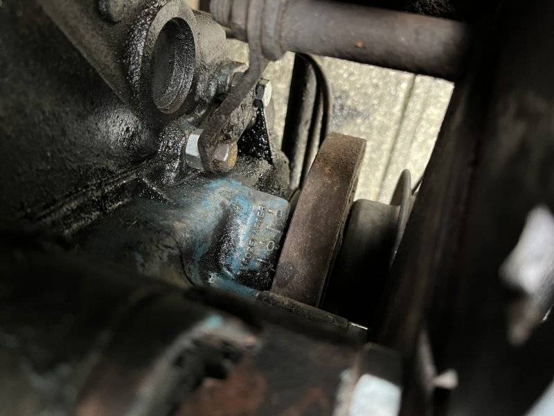

As an aside, here is what the timing marks look like on the block. Is it fair to assume that the indents (or dashed line) represents 5 degree increments either BTDC or ATDC from the O in the centre? (and yes I plan on degreasing the engine lol)
Yes 5 degree , like allready posted advance it between 5 to 10 and see how it runs once you get a light.

Make a referance mark with a marker or chalk before moving timing.

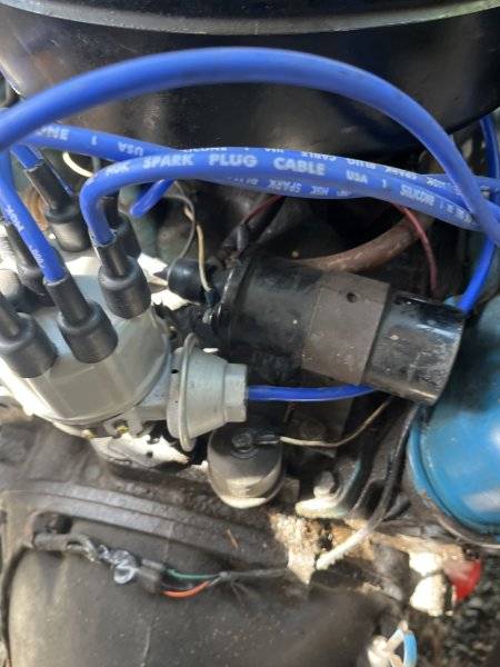

Thank you, so to get it to around 7-10 BTDC, I’m turning the dizzy counter clockwise correct? (small block)… the vacuum canister is going to hit my ignore coil though
Yes to advance you twist counter clockwise , to get another 5 degrees or so I don't think you will hit the coil.
Roughly 1/4 " mabey 3/8 should be plenty.
