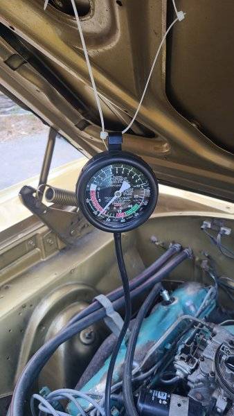

Ok, so I just want to confirm that I am doing all of this right. To check the initial timing I should disconnect the port vacuum line running to the distributor. Put my gauge on there and check the timing on a fully warm engine correct?
Yes, and make sure the idle is at curb....not elevated or you can get a false reading since the mechanical advance could come into play.

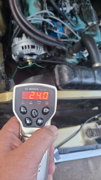

Update: Just for good measure I replaced the vacuum lines on the carb. I have it idling around 1000 rpms and it looks like I'm at 24°btdc. I didn't mess with the A/F mix screw, it is at 2 turns out.
Since I first posted the other day I have retarded the timing a touch and been able to bring the idle down with it. That by itself seems to have helped. It was hard to start when warm before. It's firing right up now. It was idling around 1350 and has something like 32°
I just took it down the road and it seemed to act better than before.
Once again I don't have any info on what has been done to this motor although other than maybe a small cam I don't think much. Any recommendations on where I have things now? Does the idle need to come down some more?
