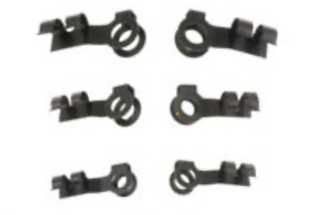

Does anyone know where I can get the correct linkage clips for the TF transmissions? I found a doorman set but don’t know if they will fit I need this style (as there are no holes for cotter pins) and might get it and see however I also need the round clip that goes over the ball on the top of the kickdown linkage. I don’t have a picture of that one but if you messed with these you know what I am talking about.
Doorman part:

The H E L P section at the auto parts stores often have those black clips in 1 or 2 different variety packs. Might need to get 2 packs to get the right ones. As far as the ball and spring clip, I've used vice grips to restore some tension to them.
Good luck.

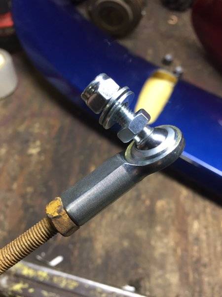

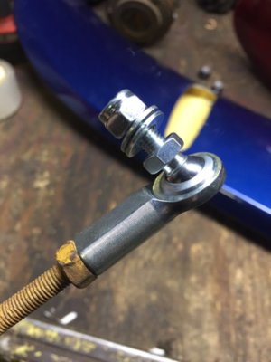

Old ball and socket clips can be a real PITA. Unless you have some numbers resto going on, I'd upgrade to a hiem joint. Way easier to acquire
