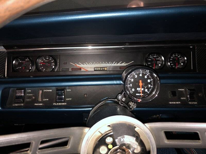

here's what I did - Autometer Traditional Chrome street tach, 2 5/8" diameter. IMO, anything larger than 3 3/8" would be obtrusive. My setup may not be relevant since it's a 4 speed so slightly different column collars but you get the idea. No shift light but if I were to have one, it would be somewhere other than attached to the tach.

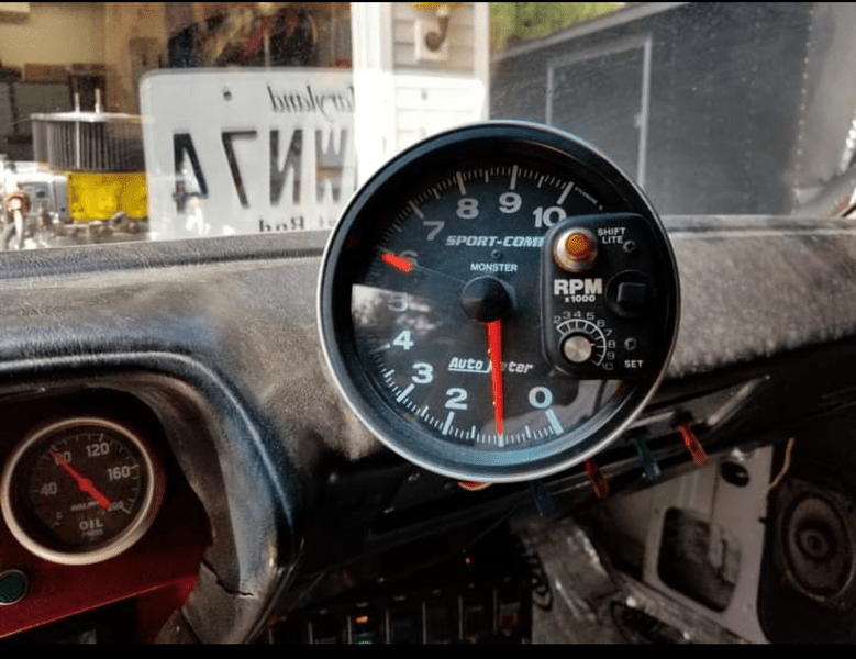

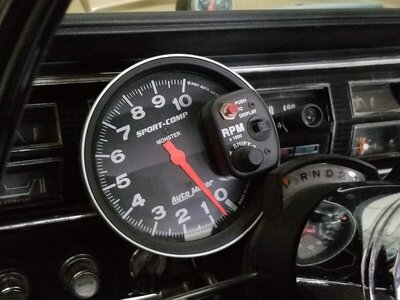

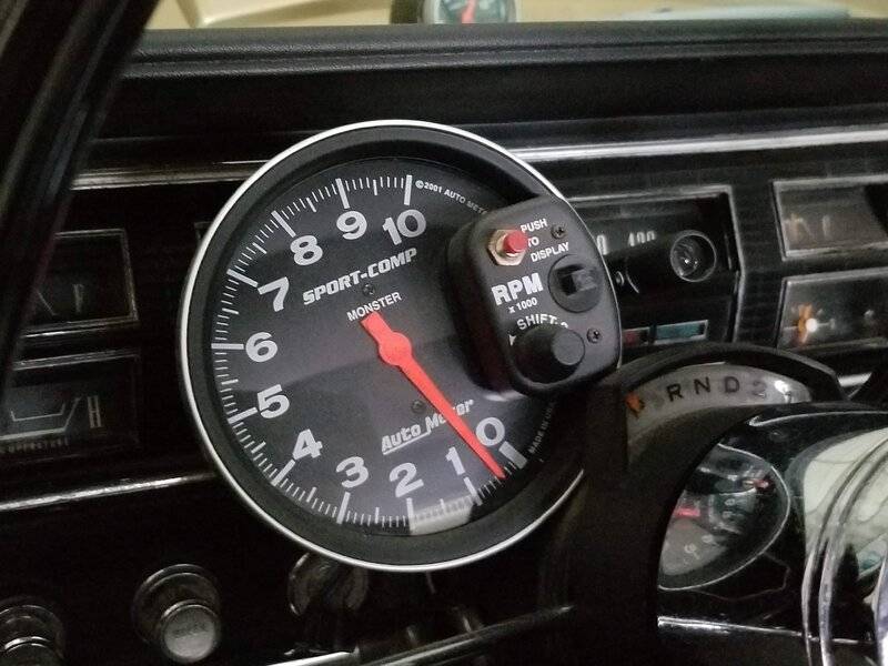

I mounted my 5 inch monster tach on the column. I used a hose clamp. Doesn't obstruct anything. Fits in there nicely.

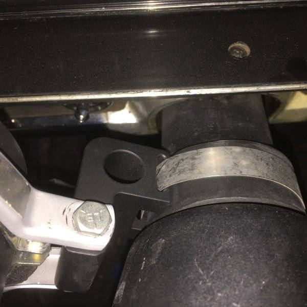

Tossing in a possible option/idea. My SW is smaller but it has a bracket that hangs it from between the cluster and dash.....
The sc bracket that bolts to the retainer ring is approx 1.5" wide and since you only have 1" will have to be cut down to fit. Could easily done.

Yea, that's what I was planning on using too, a hose clamp. But are you a manual or column shift 727? If manual, of course no issue since your entire column is unobstructed, unlike mine with the shifter taking up about >75% of the column.

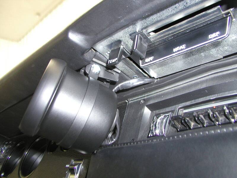

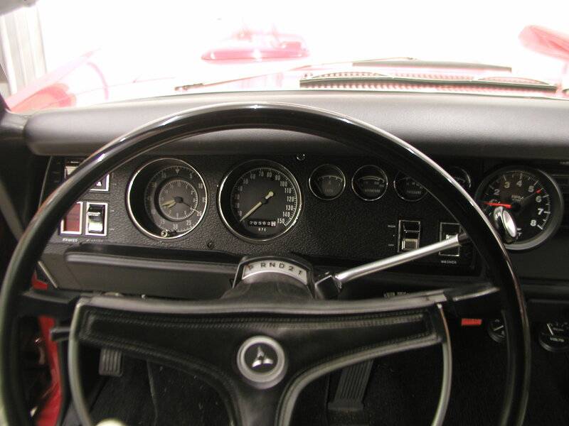

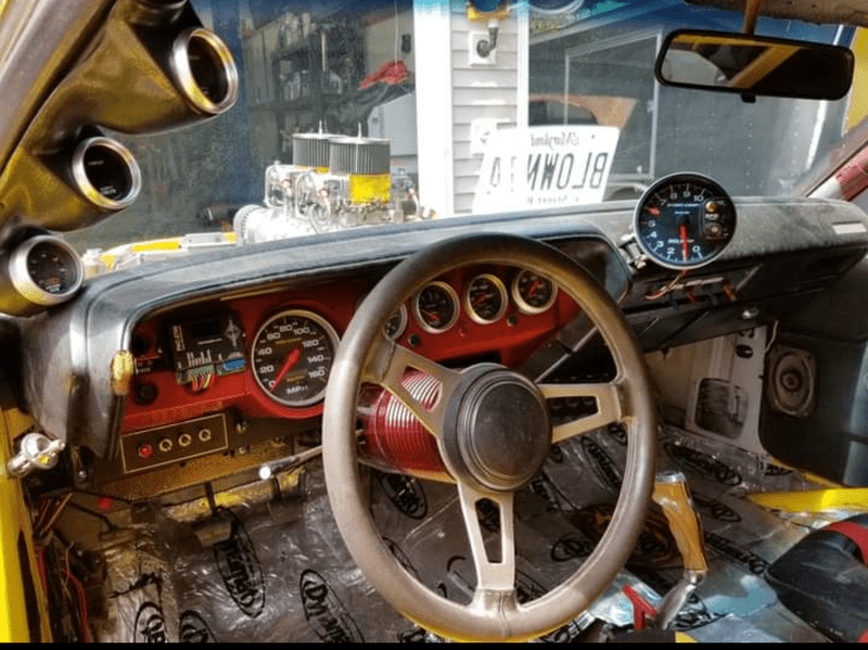

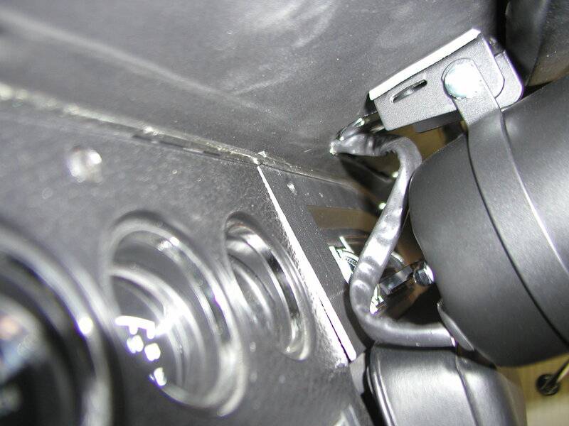

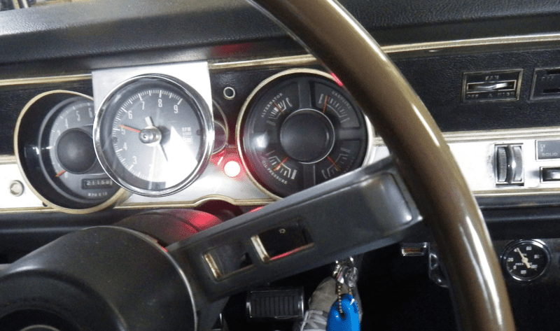

Lee, I just went out and snapped a couple photos for you to give you another option to think about versus the column mounting of the tach.
We have very similar '69 Bees and mine had a Sun tach mounted like shown in the pics back in the early '70's when I got the car. I drove it for many years like this and liked the tach location just fine. Well, 35 years later in 2010 I decided to restore the Bee so the old Sun tach came off. Now a few weeks ago I finally got around to installing the new AutoMeter tach I bought for it after the resto. I had fully intended to mount it like you have described, but after several attempts to clamp it somehow to the column, I gave up, it wasn't working out well at all.
Went back to the way I had the Sun tach mounted back in the '70's, figured that it worked then, so it'll work now. Down side is two small metal screw holes drilled into the underside of the dash, but once installed, you never see them and I don't plan to ever remove it. Even if I did, you would have to get down on the seat and look up to be able to see the holes. Cable routing easily sneaks through the opening at the back of the heater control panel with no interference to get the wires under the dash for the connections. Takes just a slight eye movement to the right to check the tach when driving, and does not block view of any of the other gauges. Well, enough chit chat, time to take a look at the photos. Hope this helps you some.

I have a automatic on the column

View attachment 1067536 View attachment 1067537 View attachment 1067538

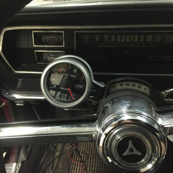

Gotta see if I can find a picture, but for my 67 Coronet (auto on the column) I machined a billet aluminum L shaped bracket that I used a hose clamp to attached to the stationary part of the column and it brought the tach out for clearance. Worked great.
