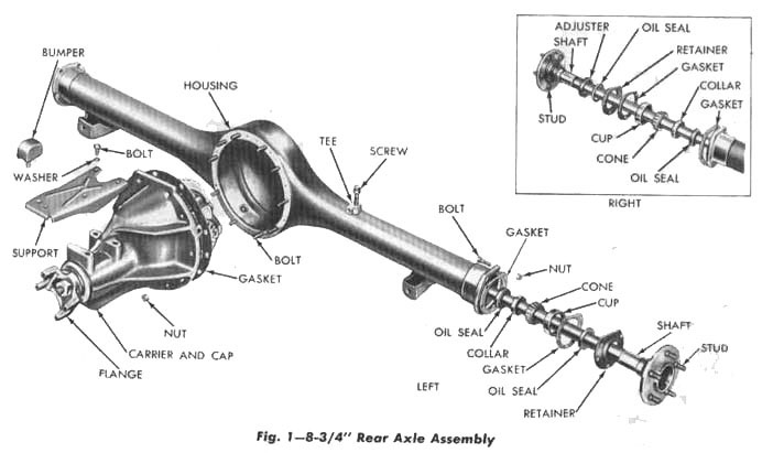

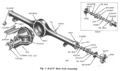

Are you setting axle end play? If not you can install all the seals you want and they will leak regardless what type you use. The bearings need to be loaded correctly to hold the axles on center in the housing. If not centered the seals are ovaled on the axle causing the leak.
Which one are you replacing? the inner seal is the one you need to be addressing and as mentioned not setting the axle end play will cause all kinds of issues.

Going to the Green bearings and solving a seal problem tells me that the problem was axle end play was not being set properly with the factory Timken bearings. If the vehicle has an open diff or the cone type Sure Grip, it shouldn't be a problem setting end play but the Sure Grip with the clutches it can be a problem if the thrust pin is missing. You just can't set it if the pin is missing. The thrust pin in the clutch type unit can come out but with the cone unit and the open diff, it's trapped in place. If the axle end play is set too tight with the clutch SG, it can cause the thrust pin to break out when the axles warm up and expand.

The inner axle seals keep the rear end lube from running out. Without an axle seal what keeps the rear end lube from running out around the green bearings? I don't think green bearings have a seal the seals it between the outside of the bearing and inside of the housing. Rear end lube is what is leaking from the seals. Wayne
Make sure the axle seals are all the way in the tube and seated so the seals rides on the correct point of the axle. also that the axle is not worn where the seal rides.
